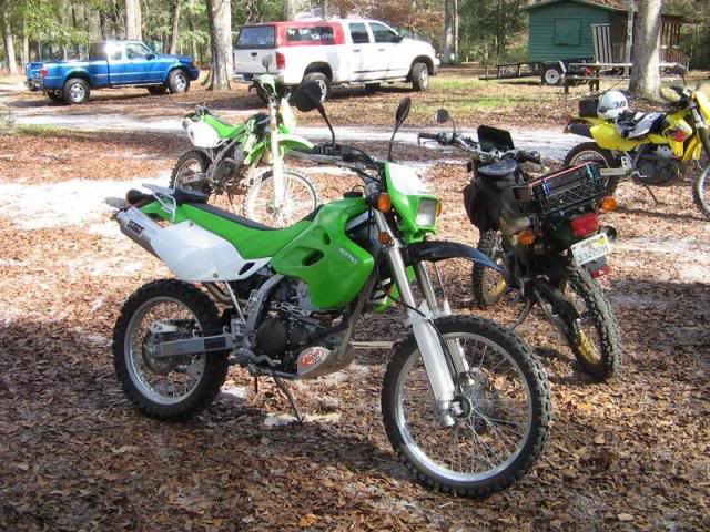

thats the only true bolt on tank..... fits, but its fugly.

if it looks like that tank then yes it will fit....

That is a funny looking tank but.....3.7 gallons! and it actually fits our bike... I would guess unibiker rad gaurds wouldn't fit under it??
Can anybody that has this tank tell Us how easy it was to install?

It's cake to install... No mods required. But I am a little annoyed at the design.
The wings hold a substantial amount of gas below the height of the petcock (about 0.8 gallons in my tank).
So even with the petcock on reserve, I can be cruising down the highway and run out of gas with nearly a gallon of gas still in the wings.
That makes me very frustrated.
I've heard of a guy rigging up some suction lines at t-fittings inside the tank to address the issue... Supposedly it works, but it sounds kind of hard to do.
