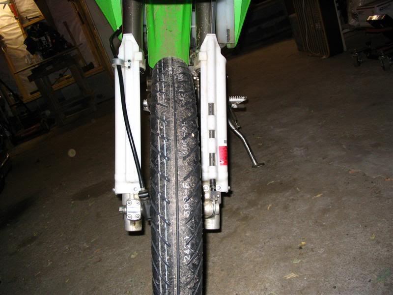

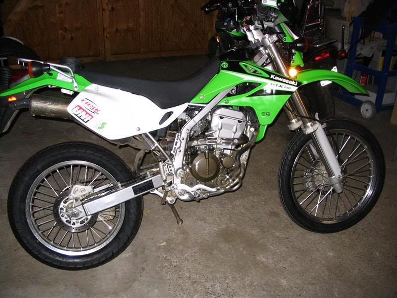

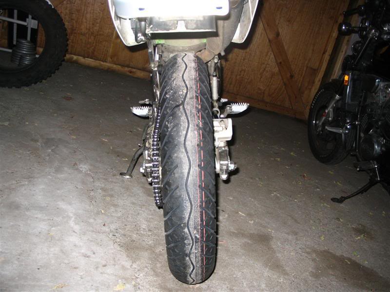

Being that its hunting season and I'd just as soon stay in one piece I threw some street tires on the KLX to save my AC-10's while I'm slabbing it. I went with Cheng Shin Barracuda's in 3.00-21 and 120-90-18 as they came pretty highly recommended on ADVrider.com. They are also sold as a sportsman class supermoto tire. They are actually a tubeless tire but I was informed that they are fine to run with tubes as well. First impressions are that the tires are a really sticky compound. Rolling them across the garage they picked up dirt like a roll of double sided tape!
As far as mounting them the front tire slipped on pretty easy, much easier than the knobbies I've done so far. Seating the bead took a bit higher pressure than usual though, ~45 psi to get it all the way up. The rear tire was pretty difficult to spoon on, about as tough as a 4 ply Trakmaster I'd say. Seating the bead however took a liberal application of Windex and somewhere between 60 and 85 psi in order for it to rise up fully.
After this battle getting them mounted, I noticed that I didn't line up the "magic" light spot on the tires with the valve stems, oh well not going to monkey with it now. My last 4 tires didn't have a light spot and I didn't have a problem, here's hoping for a repeat performance.
Being that its 10 pm and raining I don't have a performance report as of yet however I can tell you they stick like crazy on the cement. With ***** I could just slide the bike around to turn it around, not so with these. I had to pick it up and pivot around. Also these have extremely low rolling resitance at 25 front and 30 psi rear (recommended pressures from a DRZ rider). I sat on the bike and started rolling from a slight dip in the concrete. I lightly pushed off and coasted almost all the way through the garage, ~20 feet.

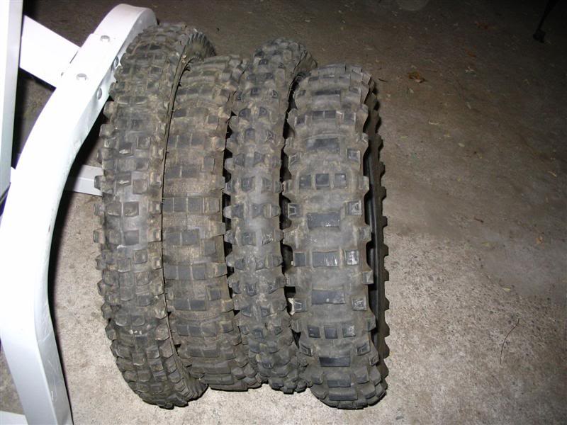

I kept the Kenda's because I'm thinking about throwing some sheet metal screws in the outer ***** and throwing them on a spare set of wheels to play around in the snow. Come spring time the AC-10's will go on the spare wheels. The AC-10's have 800 miles on them in this picture.
