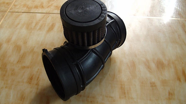

While I am confident that the timing is done very accurately, the 1/4 second between the freer breathing CVK and the 36 is nothing. Meaning it may be possible to nearly equal the 36's performance with the CVK if you can let it breath better. I've added a small K&N breather with a 1" inlet neck to an extra air box boot and will soon be seeing if that works as well as the misplaced boot did the other day. If it does then it'd be easy to add some hose and mount a small K&N filter higher up or even just run the hose into the air box above the air box outlet.
There is the thought that inlet at the top of the CVK could have been seeing higher atmospheric pressure when I was riding with the poorly installed boot and boosting the slide up quicker, but I don't think slide rise time was the factor in the increase in performance. Remember too that half of the boot's clamping area was hanging into the air stream and obstructing it, yet performance was increased.

The modified air box tube/CVK combo felt very good just now in a short test ride, with a nice wheelie on the 1-2 speed shift and what seemed like an attempted wheelie on the 2-3 shift.. Timed testing will probably have to wait until the morning when the roads are nearly empty. After that I can also test with an unmodified boot/CVK combo to the compare that with the 36mm's previous time.
