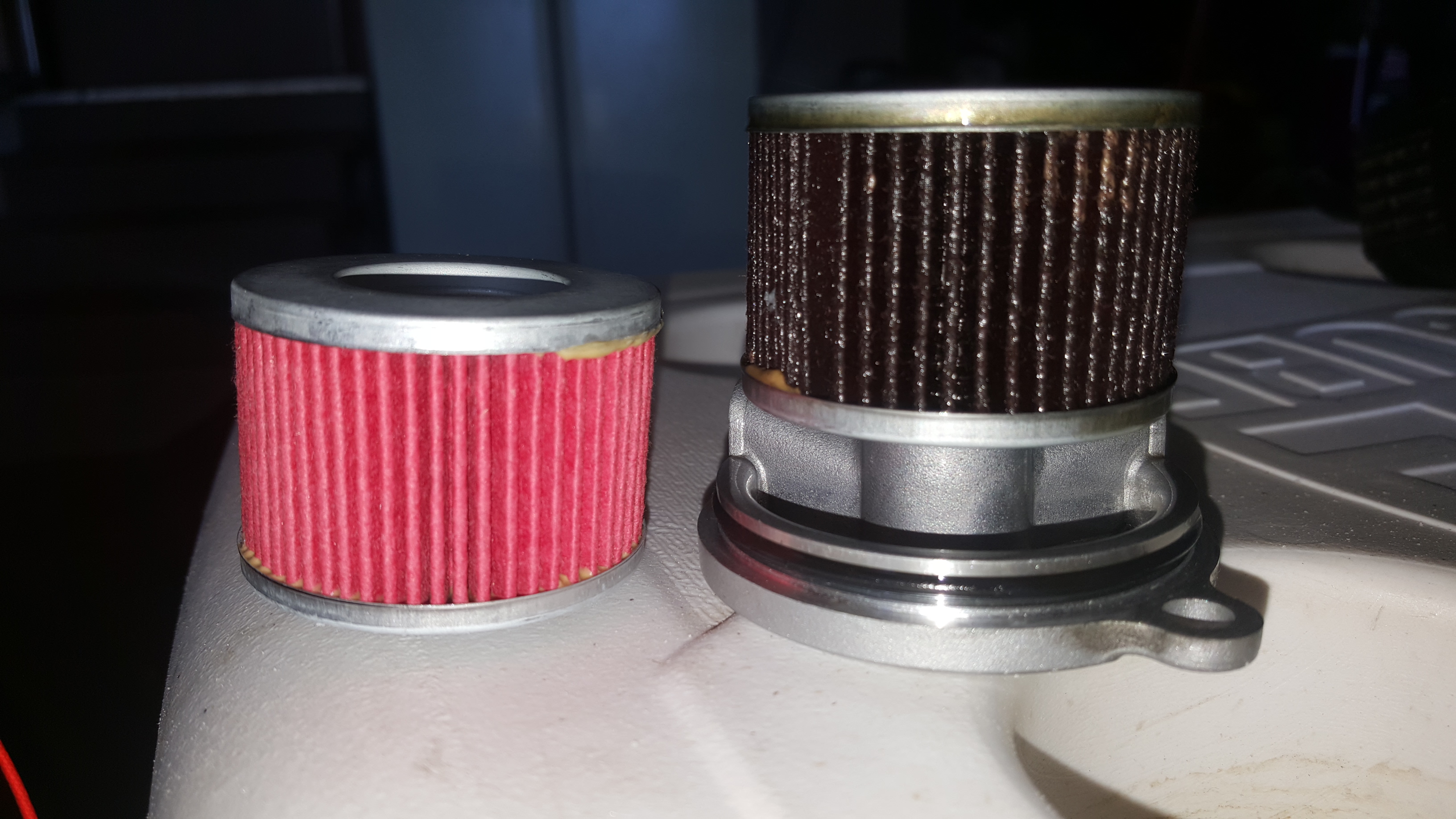

I did two oil changes after the first fill-up following the 351 install (currently at over 200 miles) and dont see suspended particles in the oil anymore, but the oil is BLACK, and the filter gets very black too.

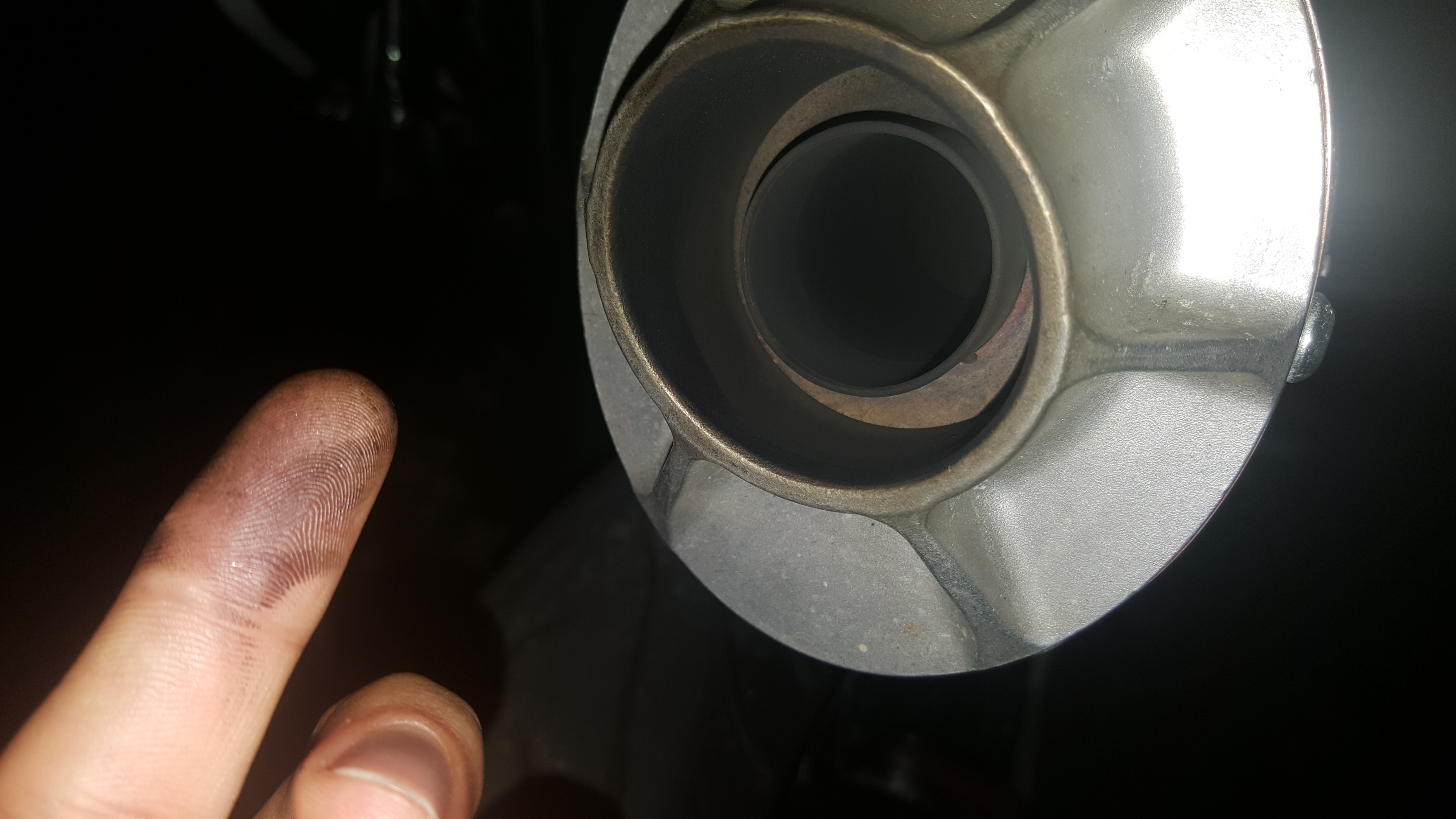

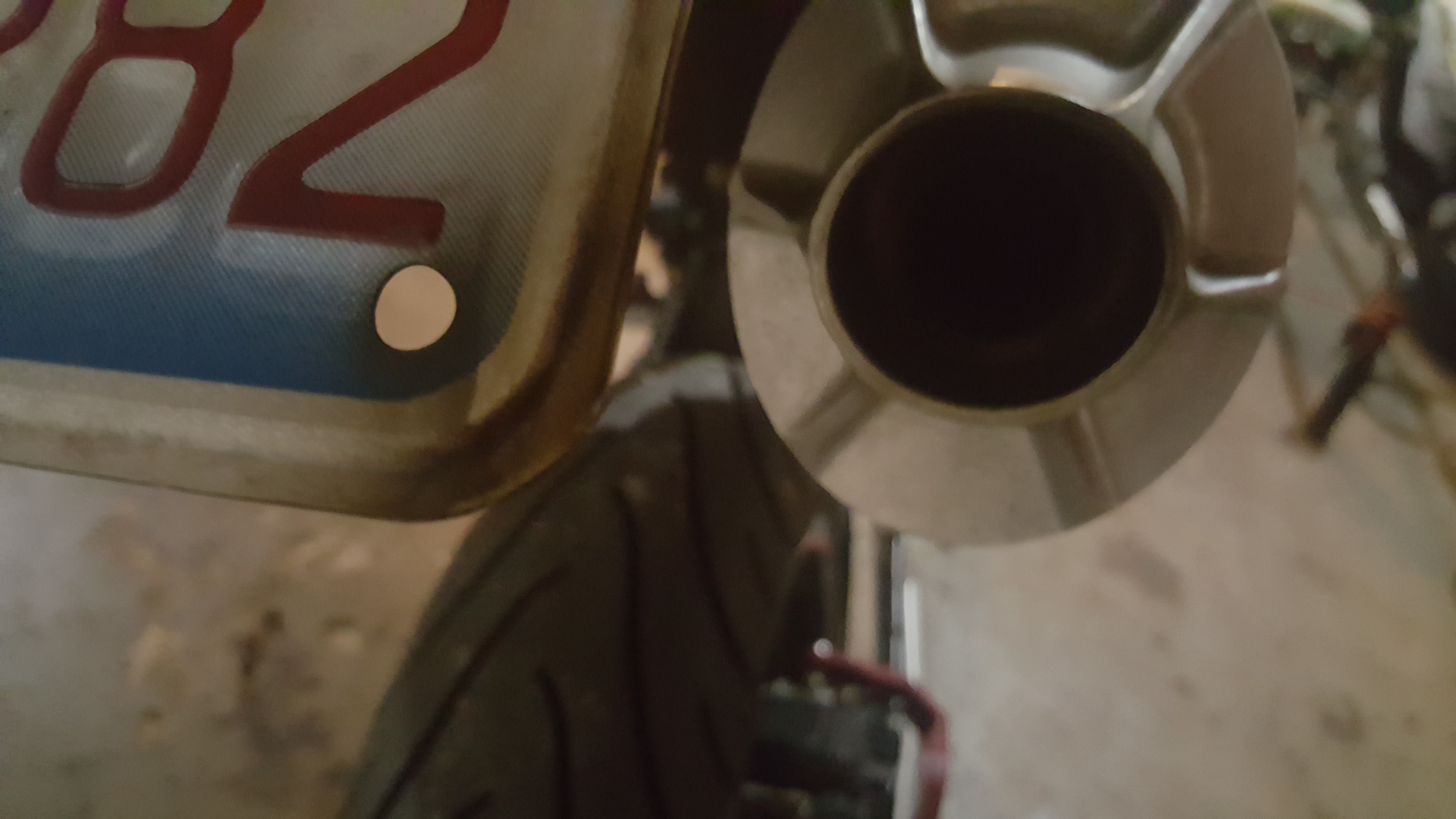

The rear of my pipe used to be just metal, now it's covered in oily soot. I feel it greasy in my fingers.

Did you get this figured out? First 200km my bb351 burned no oil. Now I am burning what I think is a lot with some white / Grey smoke at times. My pipe is also black at the tip and dark brown at the corner of my license plate.
