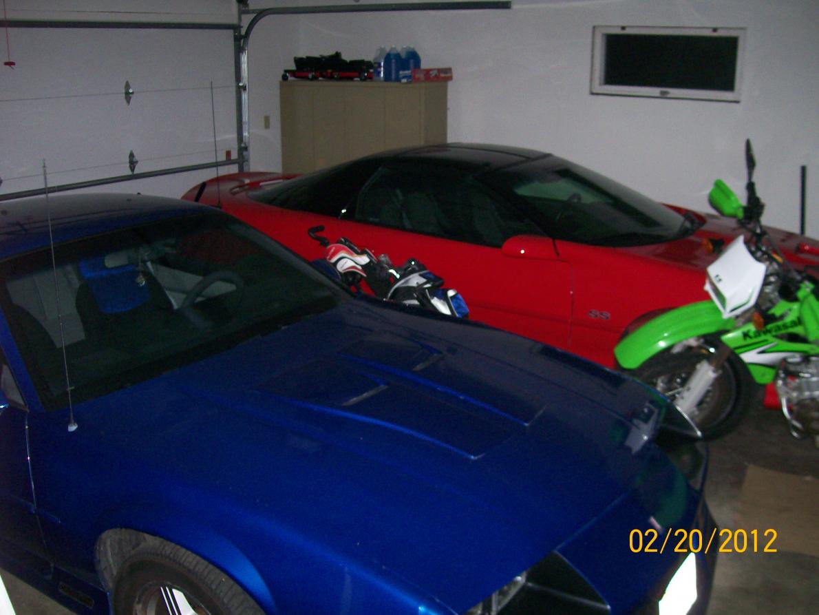

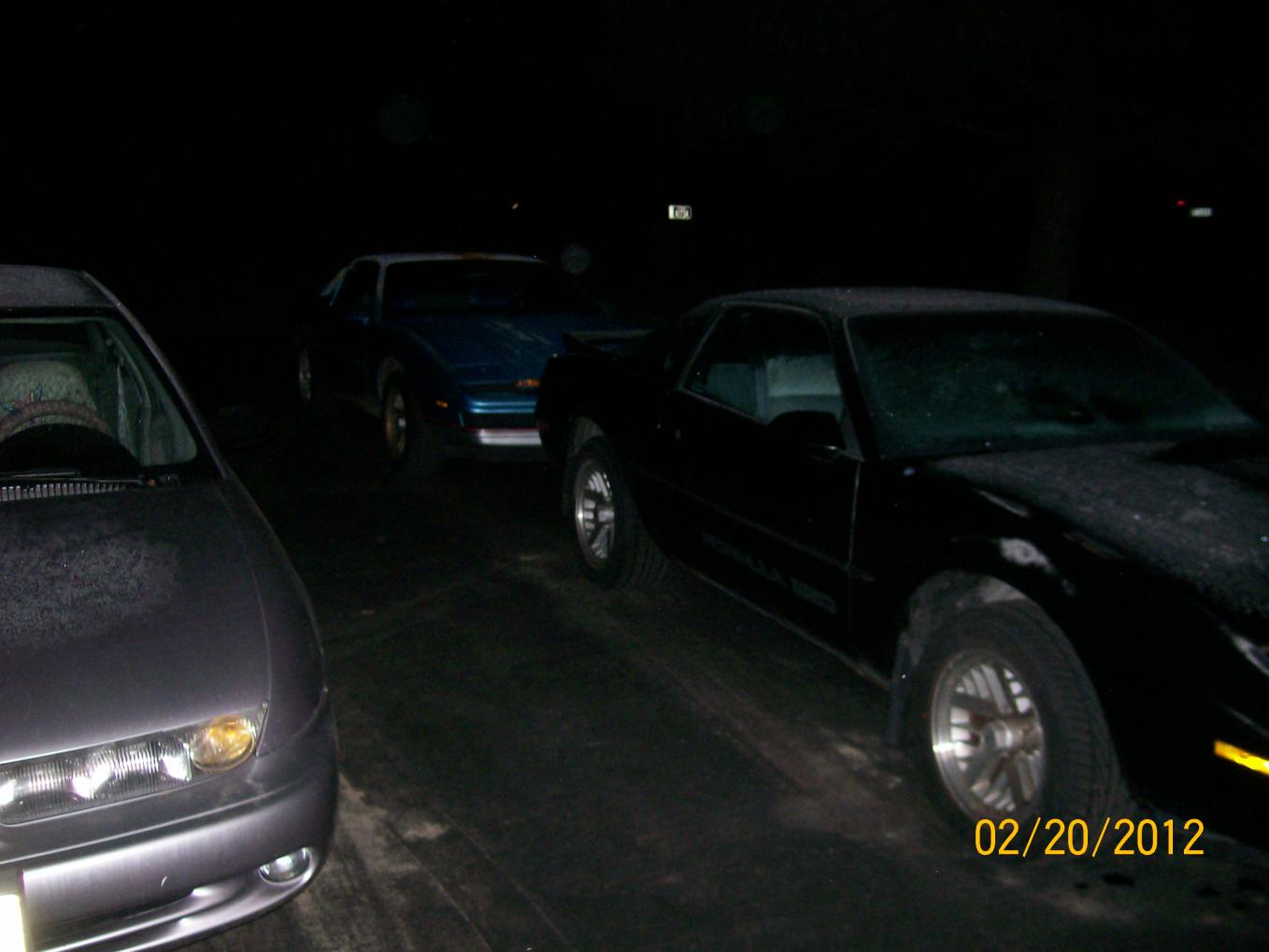

There is no issue with money at all. I just can't see spending a ton of money on a five year old bike. I'm just looking for a little more power to get my fat *** moving on the bike.
I included a few pictures of 4 of my 7 cars to show there is no problem with money. The saturn is not mine and I will never own a car if it's not an american V-8. It was to cold to go out to my other garage and get pictures of the other 3.
