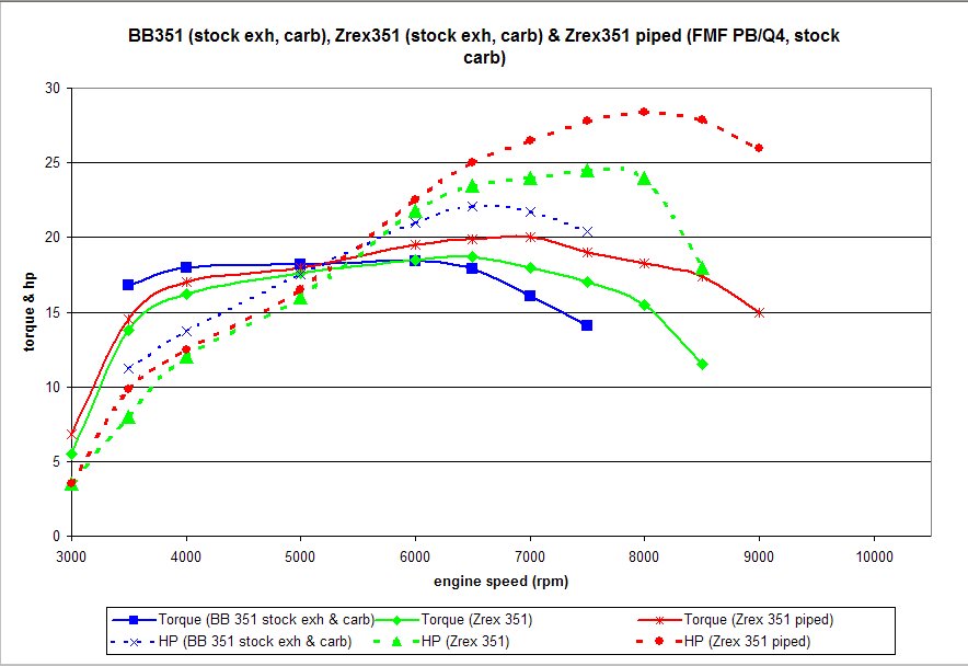

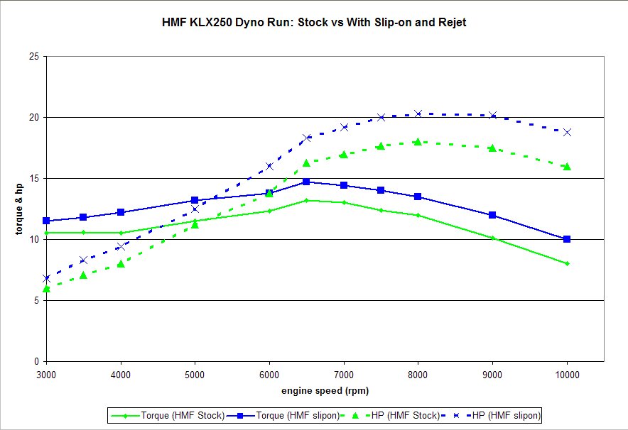

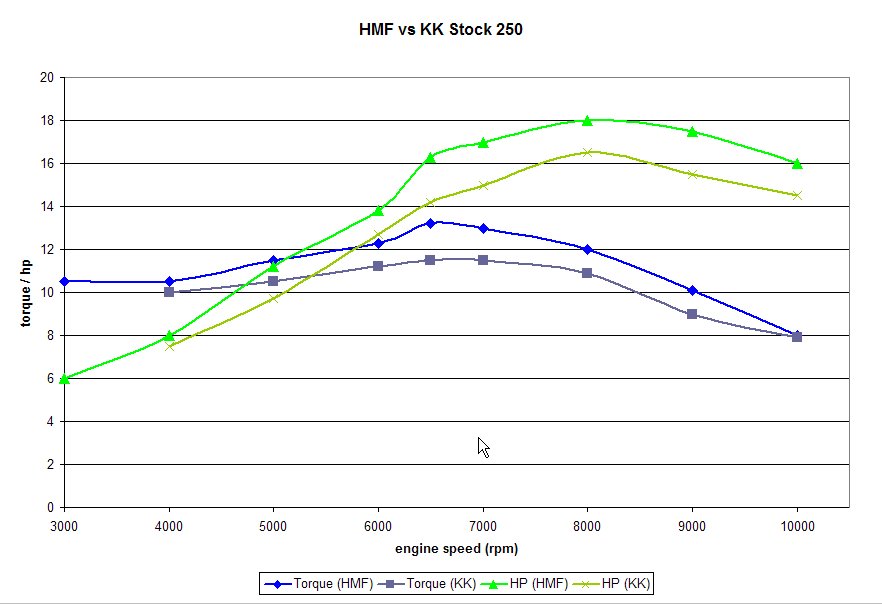

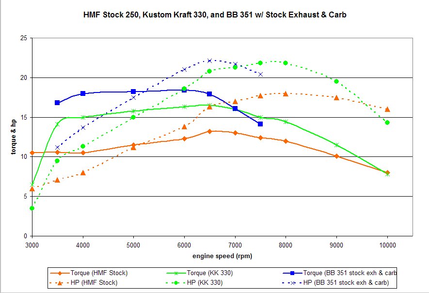

I don't have a problem getting my 351 to 10K rpm, but then again I see little need for it. I rarely take it above 8500. It's a tractor with great low end torque. IMO, if you need to spend a lot of time at high rpms, gear that bike up.
Here's some charts for ya'll. Ya, I know, comparing different bikes on different dynos on different days is a waste of time. But it was my wasted time.

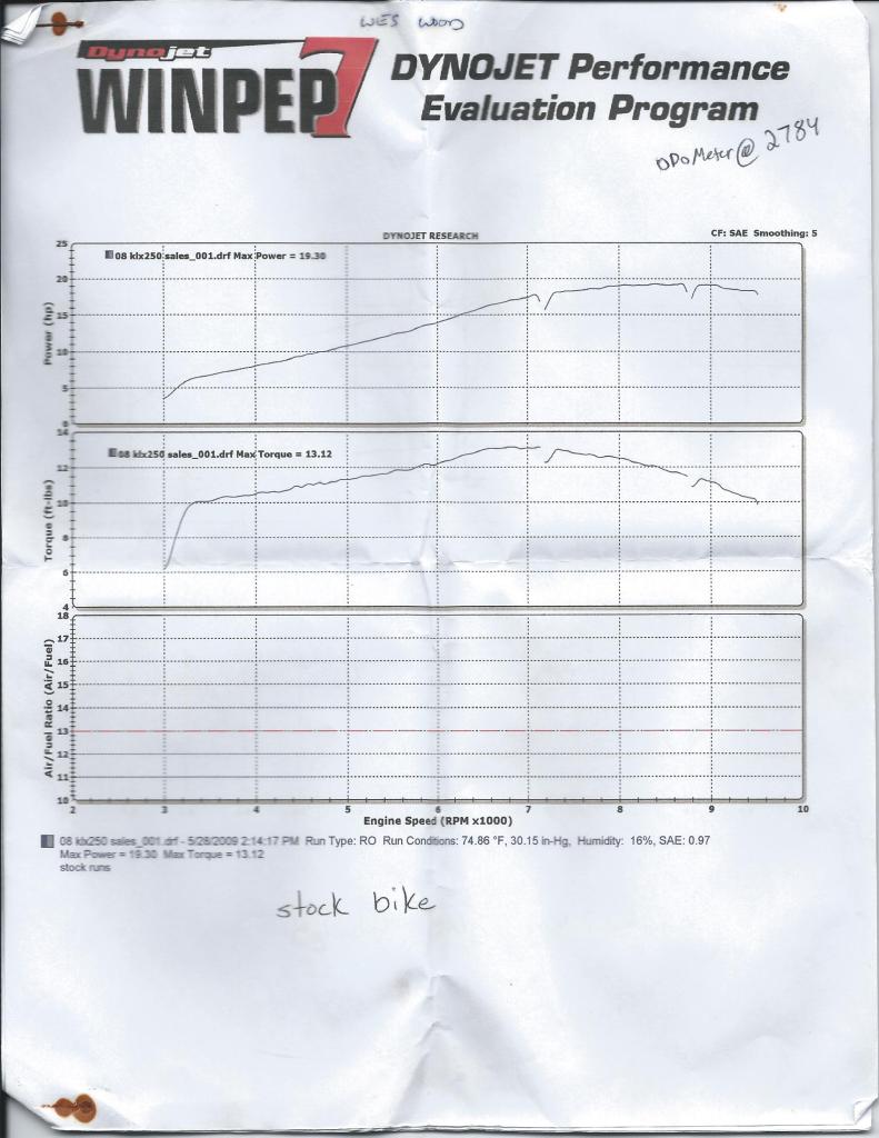

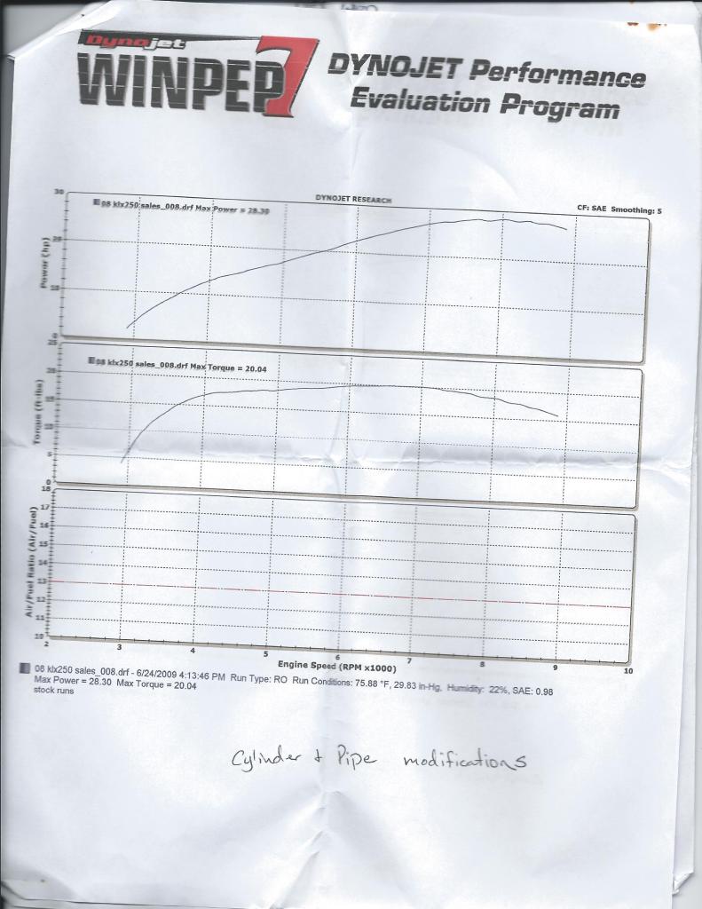

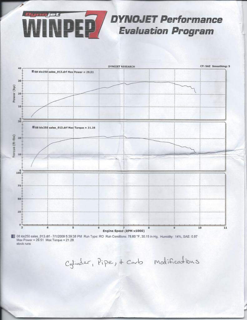

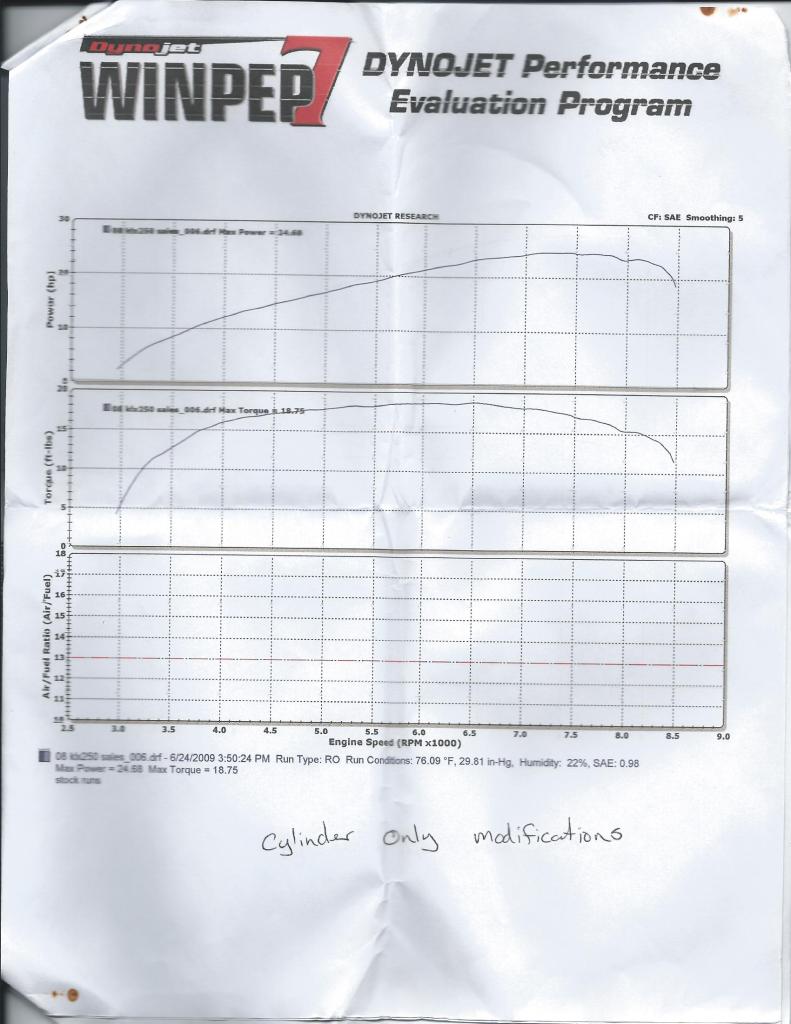

Another member here, ZRexRich, shared these with me. From this thread https://www.kawasakiforums.com/forum...lx351sf-29316/
