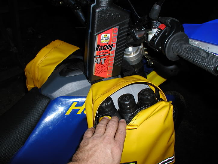

The Wolfman Tank Panniers would be a great investment (can fit 3 litres on each side of the tank.) It's by far the best solution to carry the most weight (ie Gas) in the centre of the bike, between the wheels. With 6 litres of gas in the tank panniers and the stock 7 litres in the tank you'll have enough gas for 200 miles. An 8 litre soft gas bladder on the seat will take you the last 125 miles. The key is keeping the extra 10 kg of fuel (14 litres) between the wheels and not over the rear of the bike.
