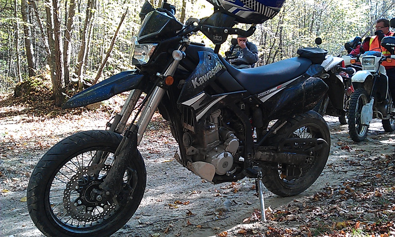

I have the SF. I really like it. You can dual-sport the thing all day, straight off the showroom floor. Don't let anyone tell ya different. No, it's not ideal, but it will get through it all just fine.
I'm a big guy (too big for the KLX) and I put it through the paces last weekend. I was doing laps around the less experienced guys on their 650s. What a blast.
The SF really shines on the back roads though. I love the 17" wheels set that it comes with. Corners on rails.
