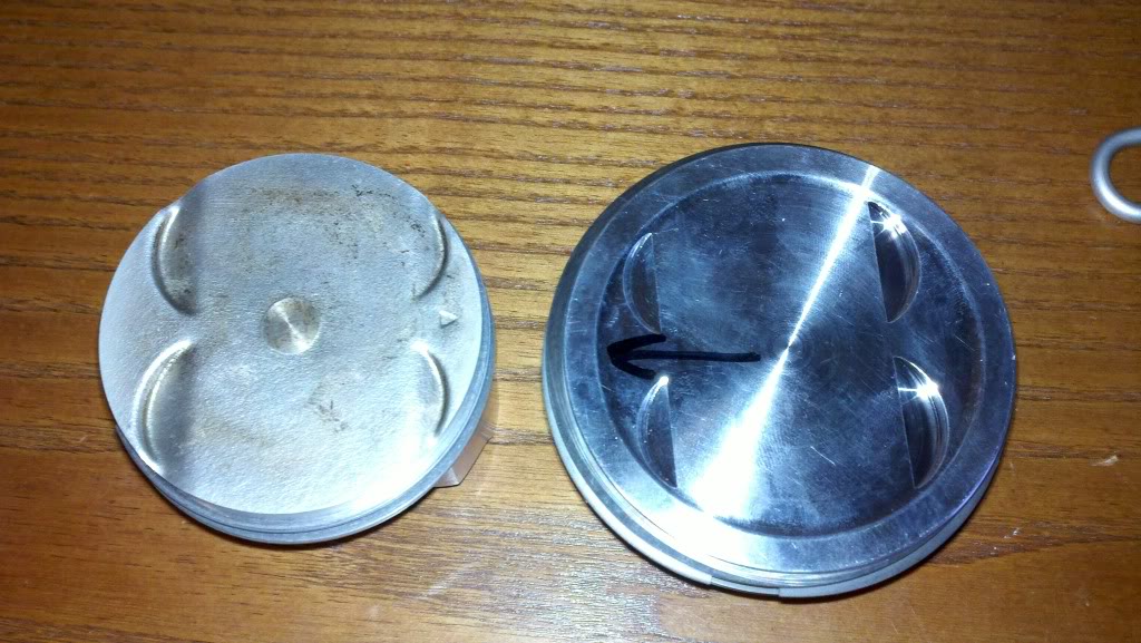

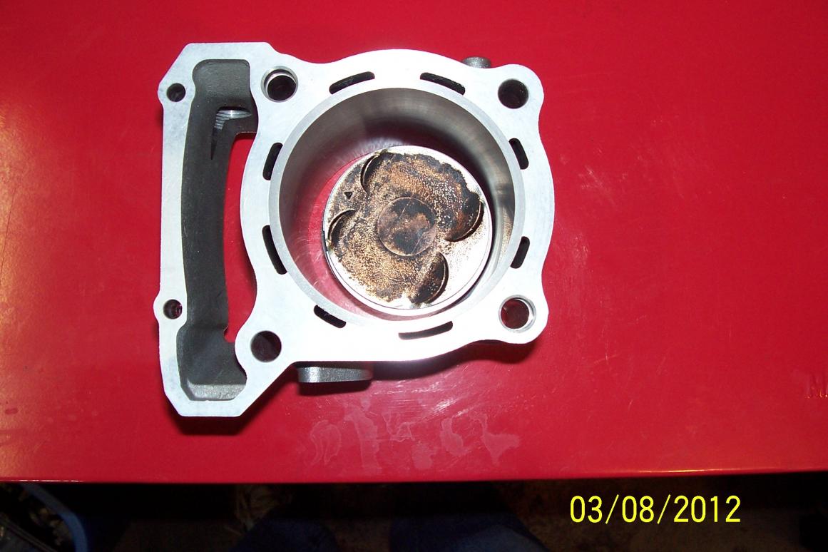

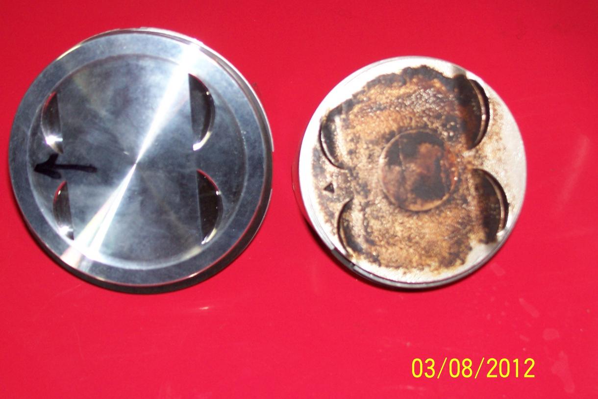

I know there are better pictures somewhere out there, but for those who may want to see the difference between a stock 250cc piston and the BB 351cc piston and bore right now, here's my contribution.
250 piston still has the rings on it so it looks a little bigger than it really is. Bill also checked gaps and installed the rings on the new piston so there's one little step that won't need doing.

Thanks Kansas,
That second pic really does it!

Wow, the second picture tells it all. I have never seen a picture like that before, only the one's with the piston's side by side. Have fun!

you have a dirty, dirty piston.....
You shoulda seen it before I scraped off the top layer of carbon crud...
Old Mar 9, 2012 | 01:08 PM
I'm thinking you need to take a look at your jetting...

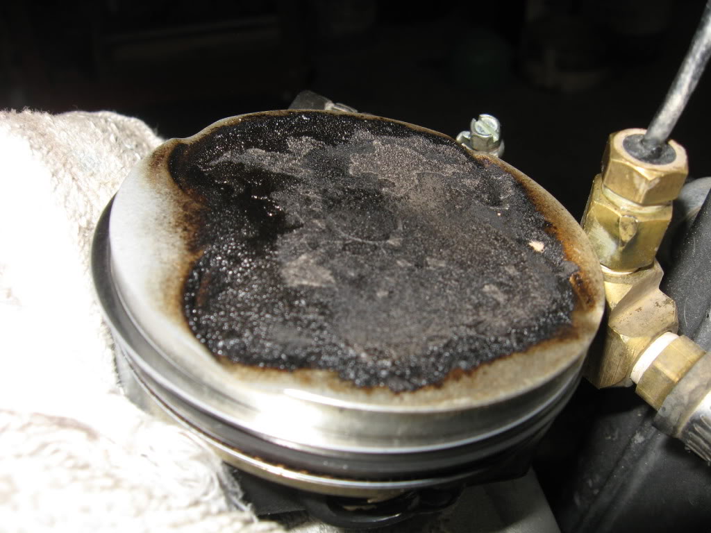

That's nothing...
