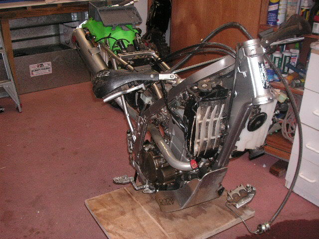

Old Oct 27, 2008 | 01:19 AM
neilaction's Avatar
Posts: 1,985
Good luck Chris.
Half a day, job done.
