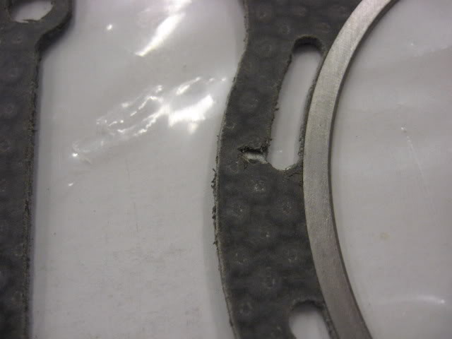

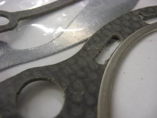

Well it looks like one major problem with my 351 was due to a water leaking into the cylinder head gasket..scored the piston a bit should hone out with some new rings but thinkn on going down to a 330 to get more gasket contact...Maybe less power but less $$$$$$ in the long end of things...
Yikes !!
Is it just a bad head gasket or something wrong with the cylinder liner ?
Old Aug 24, 2012 | 03:34 AM
IDRIDR's Avatar
Posts: 4,507
From: SW Idaho
Did you give that gasket a very careful inspection before installing? Here was my first one...

^^^This is why I'm reluctant to install a 351 kit; having the water jacket port against the metal compression sealing ring is not an ideal design. I wonder what reliability would be like such as in racing when constant wide open throttle is the norm?
