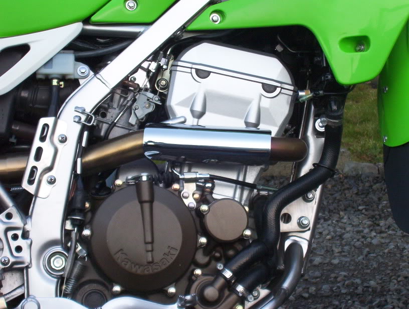

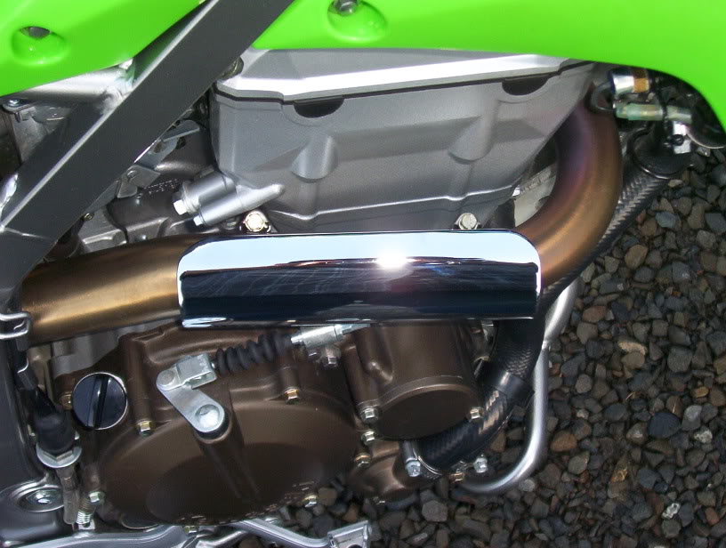

There is a search feature on this site, although sometimes it can lead you somewhere other than what you are looking for and I'm not sure how far back it goes, 300 max occurrences I think. Anyway try the search when you get a chance, its great when it works. What I did on my bike, was once when I was in the bike shop, I was looking at some of the road bikes, and they had a pegboard down bu them with all kinds of after market stuff on it, and I noticed this shinny heat shield, chrome to be exact. Well I looked at the package and thought "hey that would look cool on the bike. Here is a picture of mine, and the difference was amazing. Before, especially when it was already a hot day out, the heat would boil out and up and also I could feel it on my leg. It was hot to say the least. After installing the heat shield I couldn't feel anything. I'll post this picture of mine, and then I'm going to show an example of the search feature. Good luck man.

Oh I forgot to mention that a few of the guys have installed the stock heat shield using the same type of clamps that came with the one I bought. I think the stock one looks more like it came with the bike, but I really like my chrome shield.
