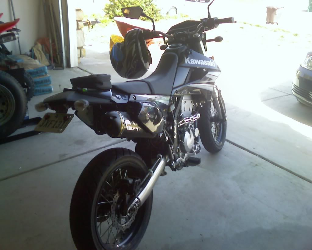

hahah nice... Hey guys i put on my Exhaust..WOW its so much better and funner to ride.. i didnt need to jet it or anything, i even to off the air lid and i didnt run as good as when it was on. but its definitley a great pipe.
It runs great!

Have u seen the pics?

Bike is lean from the factory. You'll need to keep the airbox lid on and the stock air filter until you up the jets in the carb. I have a Two Bros' also and run a Twin Air filter, #138 main jet (your stock is #118), #38 pilot ( your stock is #35) and have the stock needle raised 1.5 mm and the fuel screw at 1.75 turns out.

Yea im gonna order some jets.. but you and dready have the same jet size. where are you located? do you think the elevation makes a different thing for the jet?

Mine is a 09 with dj 128 jst and 2 bros slip on. Great improvement over stock. Riding near sea level
