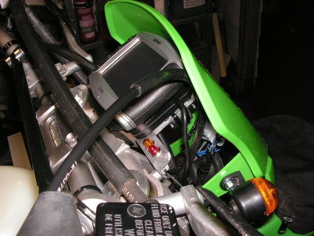

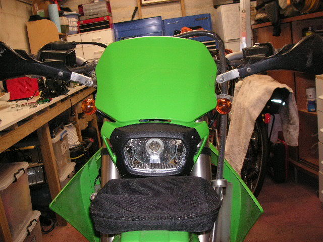

Regarding the headlight I bought a mid 90's era KLX/KDX headlight unit which fits with large rubber bands and weighs a fraction of the oe unit. It is lower rated than the stock unit at 35/35w instead of 55/60w however if you don't do a lot of night riding it works great.
http://i47.photobucket.com/albums/f1...frontsmall.jpg
http://i47.photobucket.com/albums/f1.../backsmall.jpg
how the hell do you get photos and links to work in this bloody new forum????????????
