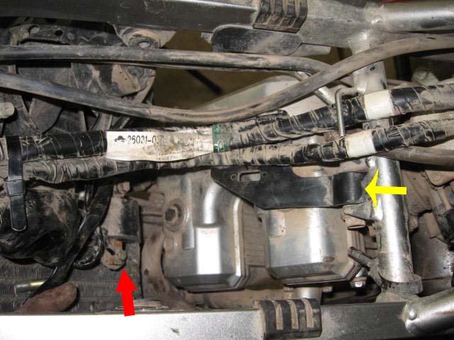

Next, remove seat, side guards, and fuel tank. In the next pic is what you'll see. I also removed wiring bracket (yellow arrow) and pulled the wires to one side. I also remove the ignition coil (red arrow) to have more room for cover removal.
Attachment 15319
Once thats taken care of things look a little better

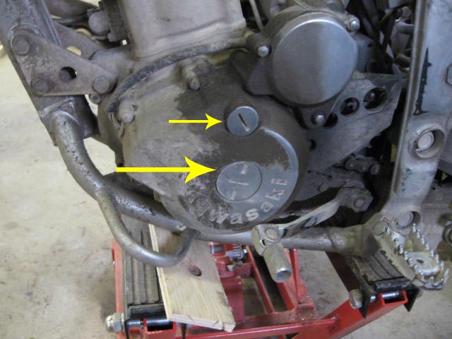

Next, remove both plugs on left side of engine case as indicated in the next pic. Top plug is where ya look for timing mark,bottom plug is where ya turn engine using 17 mm socket.
Attachment 15320

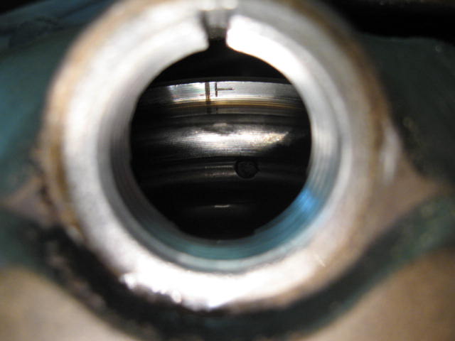

So, while turning the engine counter-clockwise look at the intake lobe of the intake cam. Watch it push down on the lifter then come back up. At this point look in the top plug of the case. Slowly turn CCW until you see a mark with the letter "T" stamped alongside of it. You'll actually see a mark with "F" first. The T is just after it. Looking thru the hole this is what you should see:

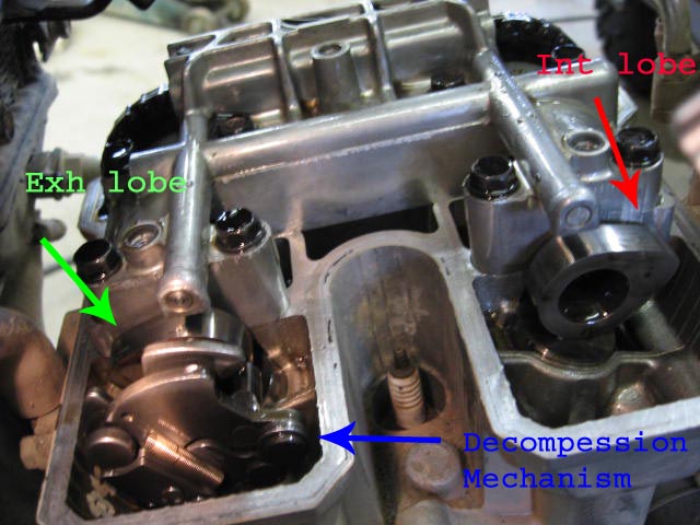

Looking at the cam lobe positions, the next pic shows what ya should see.
Attachment 15322

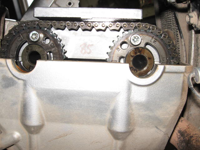

And if you look at the cam sprockets the timing marks should be level/inline with the top surface of the head like so:
Attachment 15323
Also note the mark "IN" is aft and the mark "EX" is forward. There are more marks present but the ones stated are the important ones.

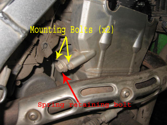

First step is to remove timing chain tension spring bolt and spring and then the 2 bolts for the mount. then pull the mount out. refer to next pic:

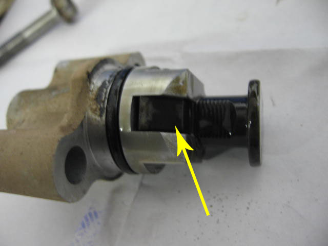

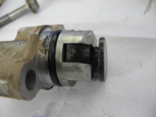

Important: tensioner must be reset. Lift up on the locking pawl (yellow arrow)) and push the tensioner rod fully in. Now it should now look like this:
Attachment 15327

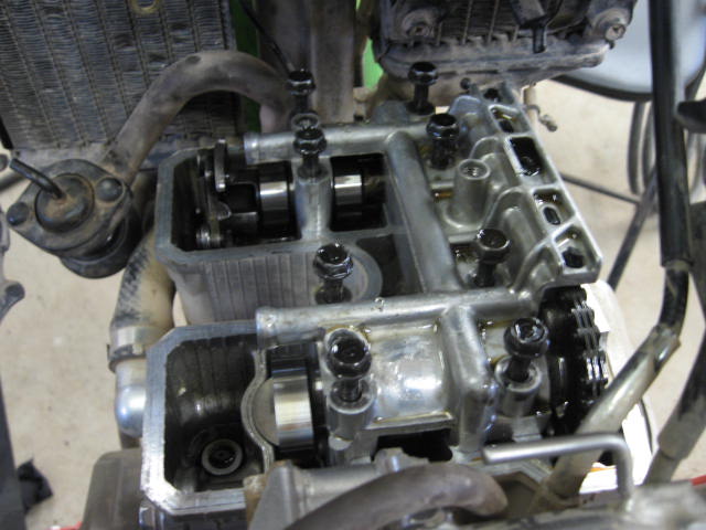

Now comes the harder part: OK... so now we have to remove the camshaft cover. In the next pic you can see all 8 bolts loosened.
Attachment 15328

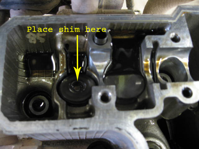

After removing bolts, cover can be removed. Next it would be a good idea to tie the timing chain off to some part of the bike to keep it from falling way down into the engine. Now you can remove the exhaust cam (if doing exh clearances). To remove cam its sorta of a tilt/tip/lift process. Thats about the only way I can explain it. With cam removed you can now take up one of the lifters. Only do one at a time to avoid mixing of parts. In the next pic you can see the valve spring where the shim sits once the lifter is removed. To the right you can see the other lifter still in place.
Attachment 15329
My shims stayed stuck to the underside of the lifter. Keep this in mind when removing lifter. Place hand under it as soon as possible to prevent dropping into the engine somewhere. Heres a pic of the bottom of the lifter and the shim alongside of it.
Attachment 15330
Measure this shim with the micrometers to figure out what shim is required to put back in. Place new shim on top of valve as indicated in a previous picture. Then place lifter back in place. Repeat for any other lifters/shims.
