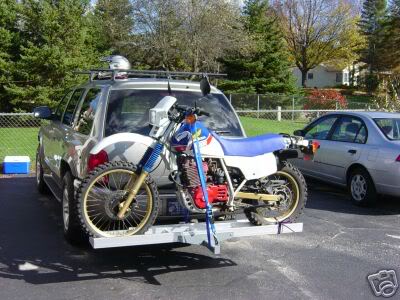

also, has anyone tried using those suv racks in the rear to transport klx250?
the bike shouldn't be more than 280 pounds.... these racks are rated at 500 pound capacities.

i have seen a dual sport klr on one of those racks... i thaught about gettin one... they look pretty handy.

Question 2: I've been eyeing the aluminium ones on ebay, but I haven't bought one yet but I will, just don't know which one?

i was searching and found this
http://www.versahaul.com/vehiclecarrycapacity.htm
be very careful about that 500 pound capacity. versahaul says it also depends on your truck. check out the real load capacity for your model. i'm bummed out cause i found out my truck can't take a klx250 :-(
Old Sep 15, 2006 | 11:57 PM
Default RE: 2 questions
Wow a question on this forum that I actually know sumthin about. Pull out the owner's manual for the vehicle in question and go to the trailer towing table. I'll use my POS 96 Exploder as an example.
Max Trailer weight is 5,000 lbs & typically your tongue load should be 10 - 15% of the trailer weight.
Max Tongue Wt. @ 10% is 500 lbs (thats pushing it on my towing ride at anything over 60 mph and I got over coils)
Now you have to consider the torque generated by having the net load sitting say 2' behind the bumper this
will reduce your tongue load capacity by about 20% or a total capacity for my ride of 400 lbs.
So figuring my KLX is about 300 lbs and the carrier is 60 lbs, I'm maxed out but do-able. That why I'm looking at the
aluminium carriers, they're lighter.... every pound matters.....gotta keep the front tires on the ground.
