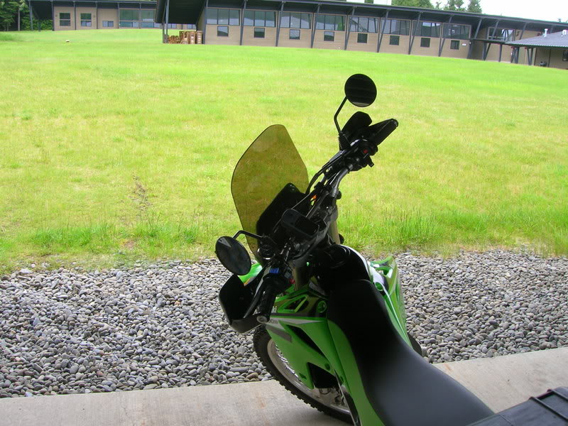

Much warmer now!
Heat gun does a great job bending the plastic! Got some black plastic covers to hide the screws just haven't put them on yet. The only "damage" to the bike was the very top piece of plastic that I drilled four holes in.
I used a piece of "pex" plastic plumbing to support the windshield that I heated and bent into this shape then ny-tied to the forks. This one was just a test part. The next on will not cover the turn signal indicator. All screws get changed to stainless and painted black including the pex. Think it will all just blend into the dash and disappear.
Plexiglass cost 4 bucks. Screws and screw covers were about 5. With tax
about 10 bucks.

I'm sorry...$10 windshields belong over on the KLR650 forums. The high brow folk on this forum use only $100 windshields and Grey Poupon.
LOL!...but seriously, nice work there. I'm not a windshield guy for the most part, but that's a pretty functional piece there...and looks better than $10.

+1 Nice work! Love to see people make their own stuff.

Nice work on the screen btw.

I like the windshield...going to keep a full-face helmet on though, right? Any way to blunt the top edge? Maybe a rubber or plastic tube cut longways and glued to it? It would make it much safer in the event of an accident.

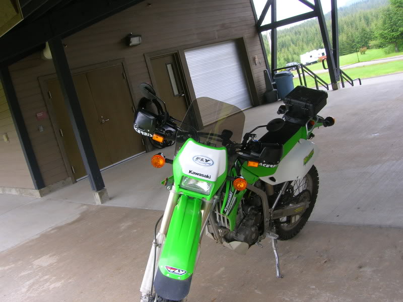

Yeah I made one of those too. Unfortunately at 60 mph it folded like origami.

That brace looks pretty solid. That looks twice as high
as my KLR shield.
they are a nice addition.

"Yeah I made one of those too. Unfortunately at 60 mph it folded like origami."
The folds on the side of mine keep it from doing that
