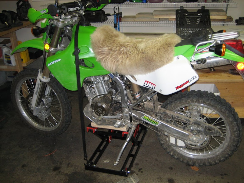

That's a bummer about the tank situation. The gas stations are few and far between around here. Im getting around 110m per tank and that limits my adventure riding in this wide open area. I wounder if i could get someone to fab a tank (metal) that would give me one more gallon and still look good and fit using the oem shrouds?
Now on the big bore mod.....if i go with the 300 kit is that oem from Kawasaki like sleeve, piston and carb?
Hey Kawi dude...whats up with the rug on your seat? The hunters up here would take a shot at you, hehe joke!
Thanks for all info!

oem from kawi is cylinder, piston, rings- just like a factory if you install it correctly. big-bore is either a 300 cylinder bored out to 331cc or a sleeved 250 cylinder into 340 or I think 331 as well. The trade-off is that if you use your oem 250 cylinder you have the downtime whereas if you can find a used 300 cylinder (or buy a new one)you can just send it to kustomkraft.com and they can bore it and replate it with nikasil and you have no down time. There are varying opinions on which way is best and more durable.
