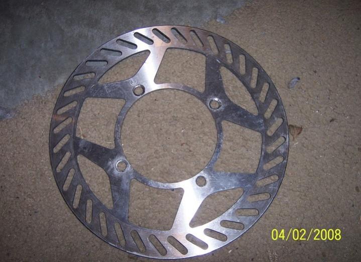

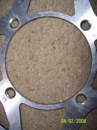

here's the rotor I speak of.
Attached Thumbnails 07 and earlier rotors on an 09?-rotor2.jpg   07 and earlier rotors on an 09?-rotor.jpg
