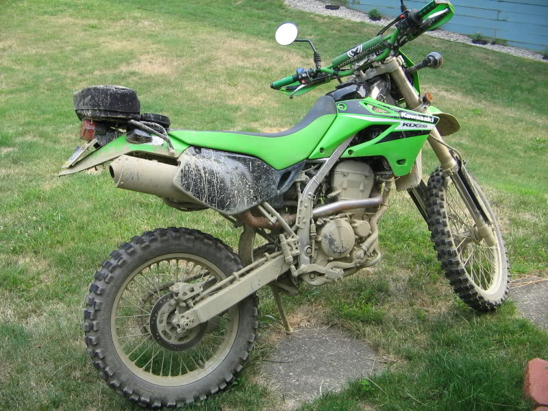

Dude she doesn't want to see dirty pictures of your bike.....ok I don't but still.
