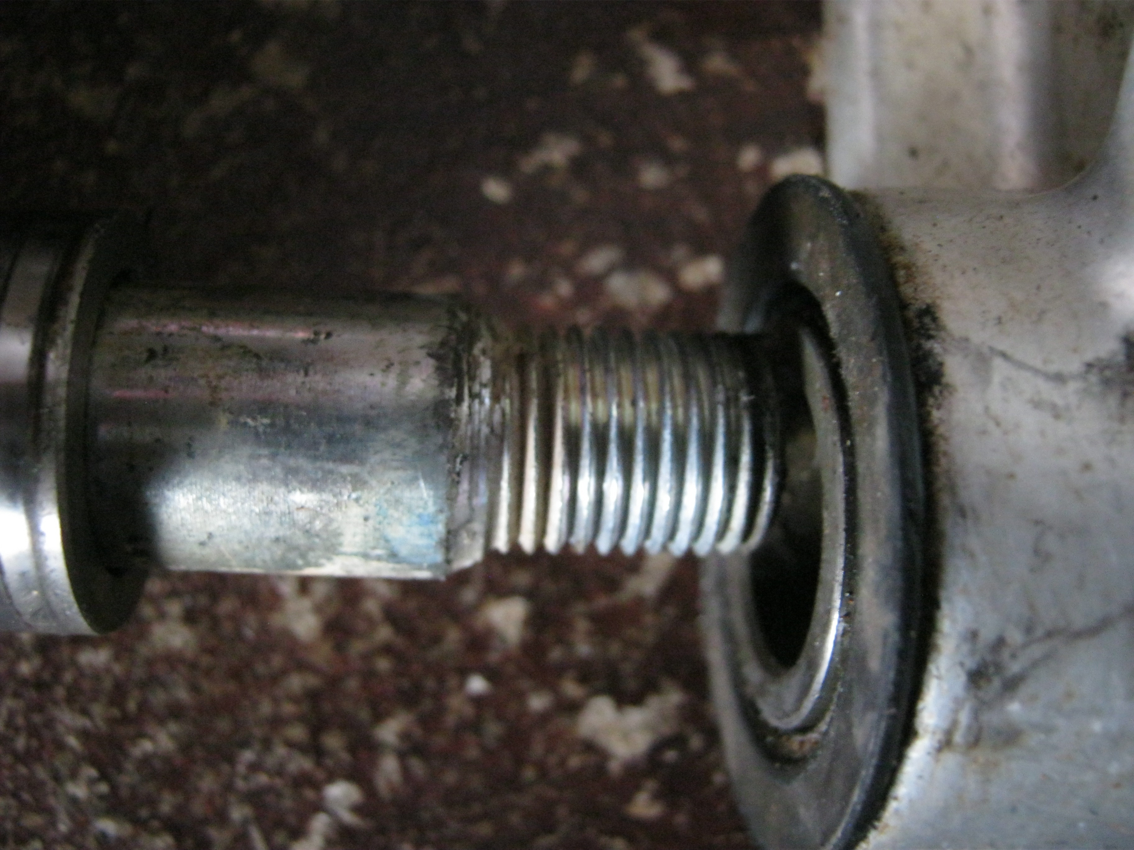

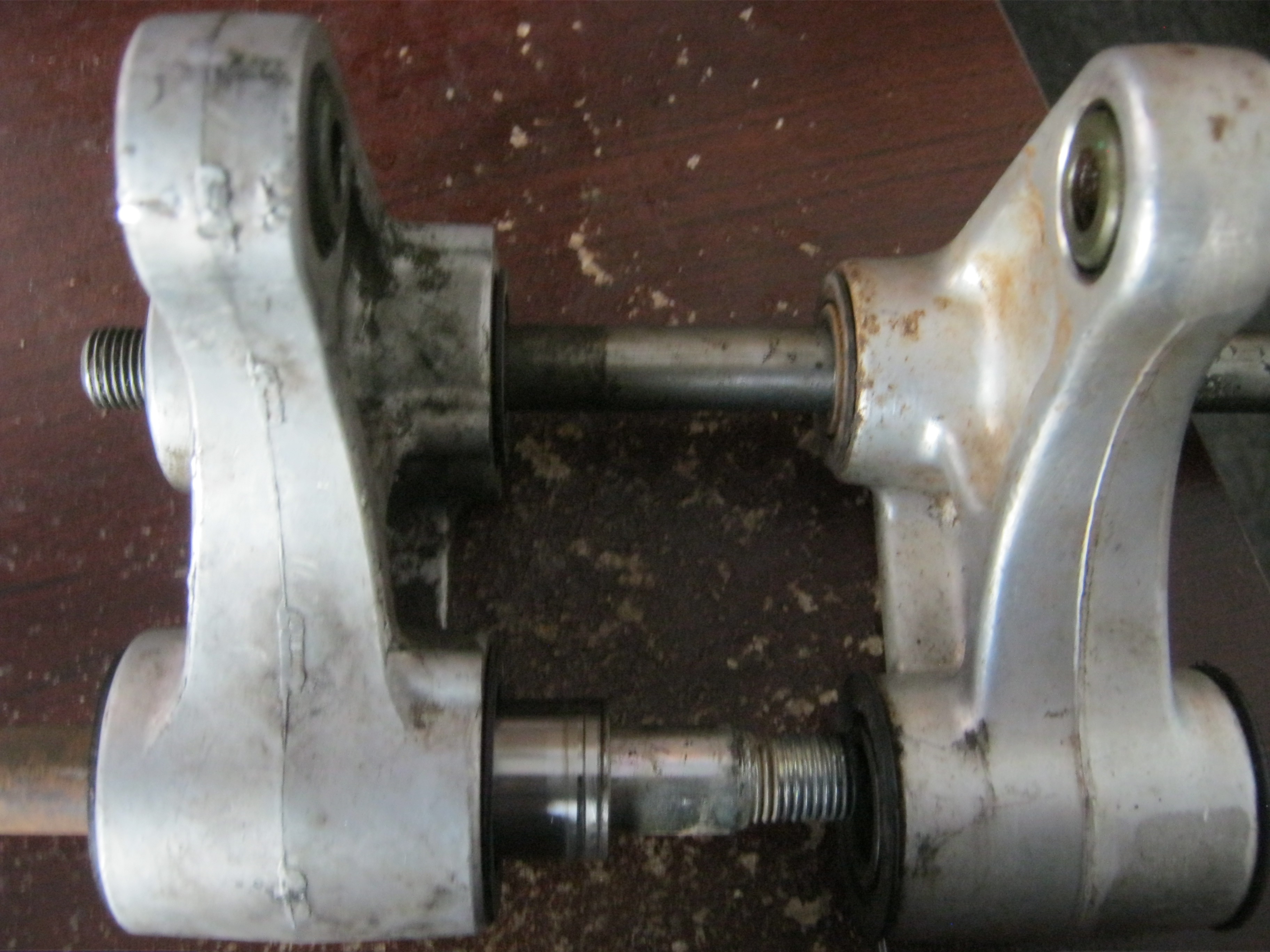

Installed the linkage from the 300, but with the 250 dogbones to give a little (minimal ) drop.
Height remained the same, but I was right about the difference in ratio. It made the rear softer, and changed the sag I had set at 75 mm to 100 mm. I reset it to 85, and it feels much better. Before the adjustment it felt really soft.
You can see the difference in the linkages. 250 linkage on the left
Was that with the 300 shock or the 250?

If you read the previous post, it was the 300 shock with the white 250 spring
