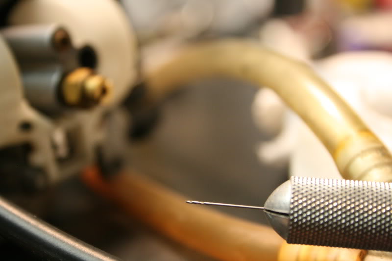

Old Mar 16, 2011 | 08:22 PM
If you go to Harbor Freight, I would avoid the solid carbide bits they sell. These are left overs from plants that Mfg circuit boards. They are good bits, but carbide is unforgiving when flexed, and will break. Drilling by hand you need the bit to flex some as you will not be able to hold it exactly centered while rotating it. Steel bits will flex/bend without breaking while you auger out the hole. A pin vise is the best tool to hold the bit with, but I was able to get my bit centered and held in my x-acto knife. If you do that make sure it's centered, and parallel to the handle.
Dan
