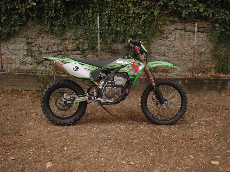

this is klx 250 with subframe kxf 2004.nice bike
Vito, just curious...did you replace the KLX subframe because of a failure or another reason? Do you have any closeup pics showing how you mated the two?

not my bike.In Italy there were two preparatory movement that made this change, the first of superstructures used kxf 250 of 2004 and another of kx. questions is the modification site with pieces of kx: http://www.panterelucchesi.com/index...a/02_restyling
Very interesting...and some good work as far as I can tell from the pics. That took some time and some good fabrication knowledge. Not sure I'd want to go to that trouble on a KLX to do that, but the finished product looks excellent. Thanks for that link.

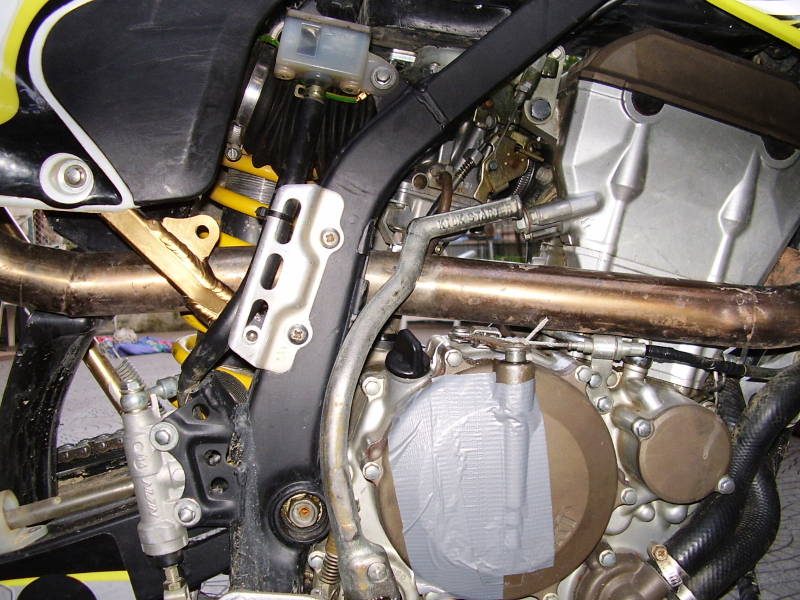

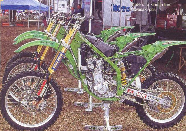

the subframe, the plasic and airbox are of kx and kxf 250 2004. I enclose photos if it is more clear verere
it's clearer now, not whole subframe swap, but only rear frame and rear fender swap with kxf version in order that the rear monoshock kxf can fit in it.....
