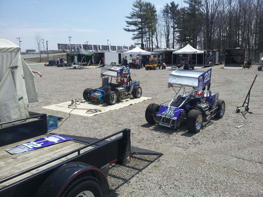

And when you say minis what do you mean? Or you talking the car?

I was at the dirt track last year and they were running the gokart rides and the rides like that. I was not sure on what name they went with. The legends are the older car mini's that I was thinking of. Like a '37 ford look but made to fit. lol
Thanks for the pic, that looks like a helluva time.
