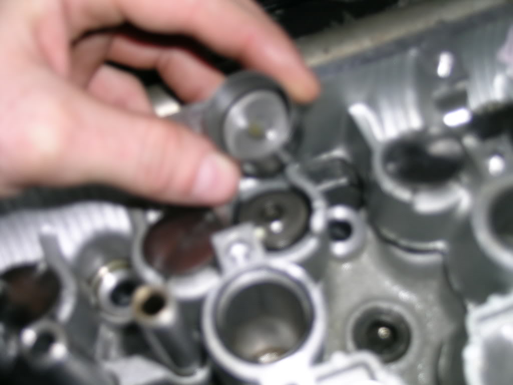

no rocker arms in there.. its shim-under-bucket...
i'd do the simple stuff first.. chain tensioner and oil change.
