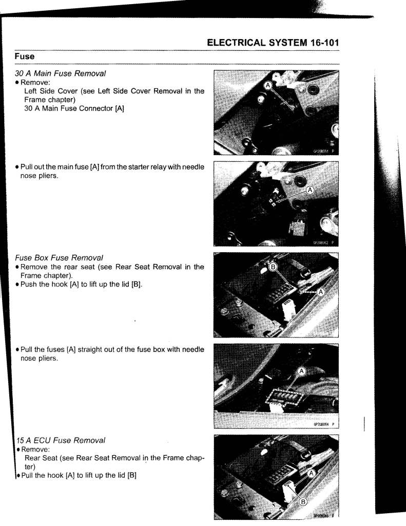

Bear with me man, I am trying to learn this ride as well. Is this the fuse? The 15 amp one?
Old Dec 22, 2009 | 02:07 AM
I know, ecu fuse. Just grasping at your pics and happenings.
