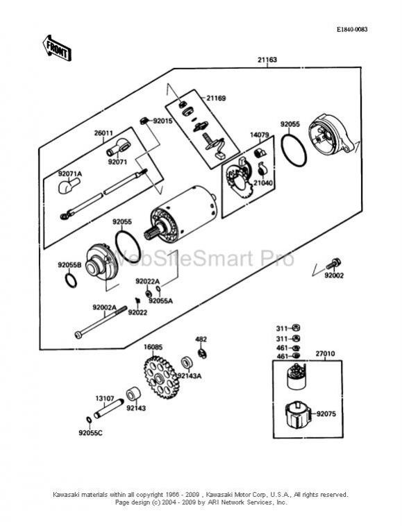

The ring gear with the starter, actually I hear the starter turning but the gear are broken so the motor dont start.
Where I can find a manual? Does it explain how to change this thing?
Is there are an equivalent of hayne car repair manual for moto?
Thanks
I attached the schema of the starter for my bike, but that not show what I need to do to remove this gear

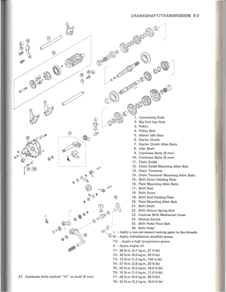

Old Jun 21, 2009 | 02:22 AM

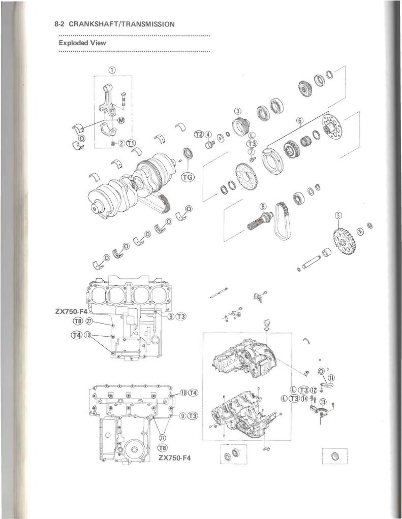

here ya go:
edit: threw in the torque numbers and break down as well.

Do I really need to remove the engine from the moto?
Ho boys, I was sure its was a little less complicated
Edit: Thanks for the images. I hope I dont need to remove all the engine
