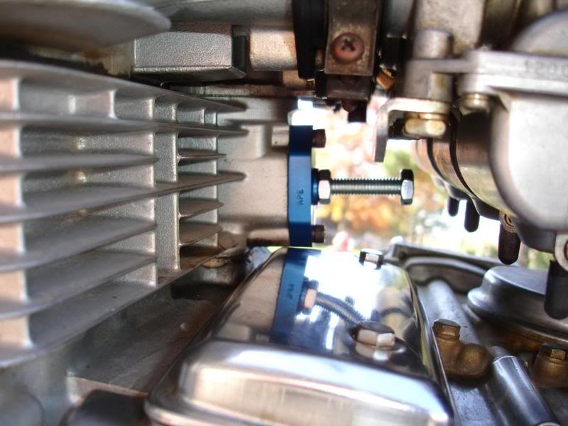

Without a doubt your cam chain tensioner is shot. I had the same problem with my KZ750. The factory tensioners have an extremely high failure rate, and were even recalled back in the day. Without enough tension on your cam chain, that chain will just slap around making the nasty noises you hear. this also causes some major timing problems especially when jumping from high to low RPM's. Do yourself a favor and buy a manual cam chain adjuster. You'll never have to worry about a slacking cam chain again.
With a manual cam tensioner, you will have to adjust it occasionally, i.e. every valve service.(6000 miles) But, it only takes a minute to make the adjustment.

Nice pic mark
