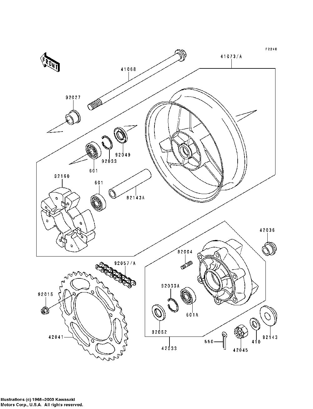

Yes I agree, when putting it back together it only goes one way, Look at the picture and make sure you have all these parts.
Also make sure the brake caliper was reinstalled correctly, was the scraping there before you replaced the sprocket?

yeah, that's exactly the way it's now. I don't believe the scraping was happened before hand.
