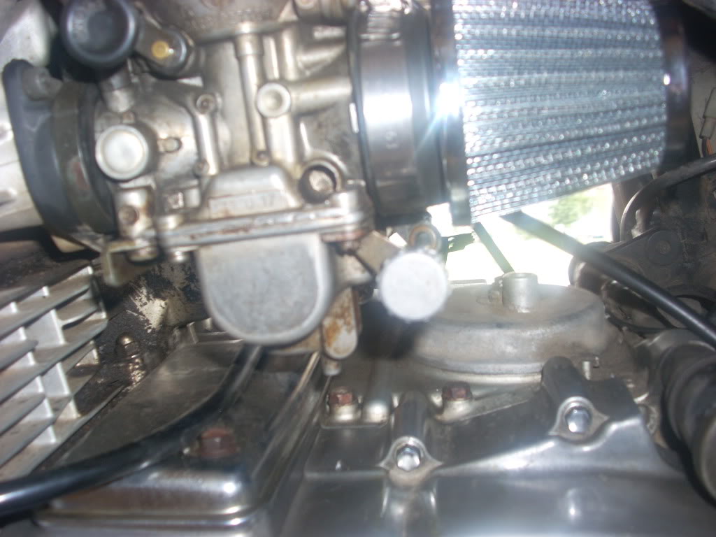

One thing I couldn't figure out, is what is the little metal **** under the filters on the carb? (Not the choke of course) See pic below:
ok, you are running pods and not the standard airbox. Now is a good time to list the pilot jets and the main jet sizes used by the previous owner, or better yet, time for some carb disassembly lessons from your manual. Log all of the info, and record it. How many turns, sizes, float height. (and cleaning experience)
Whats up with the oil leak in the picture?

As far as the oil, I"m not sure and hadn't even noticed until you pointed it out. I haven't seen any leaking onto the floor, but yeah I'll have to see if that is fresh and currently leaking...
