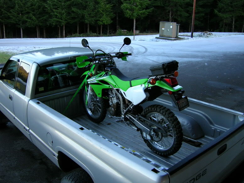

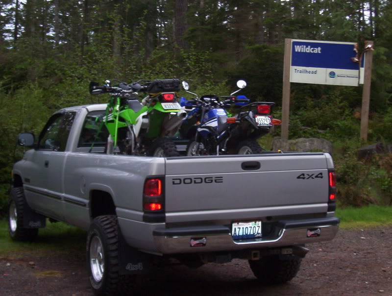

Old Apr 25, 2007 | 05:37 PM
Default RE: trailering bike
I found a picture of the first time I hauled my bike, notice that I only have a strap on each side of the front of the bike. Some one in here mentioned to lean the bike on the kickstand and get the front tire in a corner and start with the low side, that sounds like the best for a trailer situation. If I'm going to haul the bike a long distance I use the fork support and 4 ties just to be safe. Let us know how you did.
