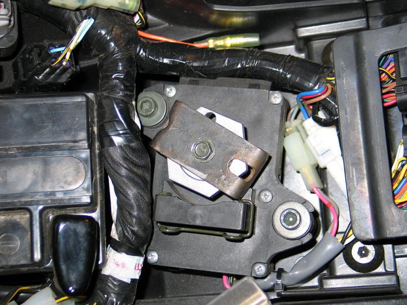

hey guys i change out my exshaut on my bike and put a muzzy on. but now i have this F1 light on how do i get it off or is it a big deal..

The aftermarket exhausts dont have the power valve. I have heard there is a fix for the muzzy dunno anything about it tho. But its a pretty common topic, I know we have a thread of two around here. Try searching around untill someone comes in with the answers.

to save you some time...you just need to get a servo stop to keep it from spinning which causes your FI light to come one...some are pretty cheap or you can spend 100+$$$ from Ivans pictured below...
