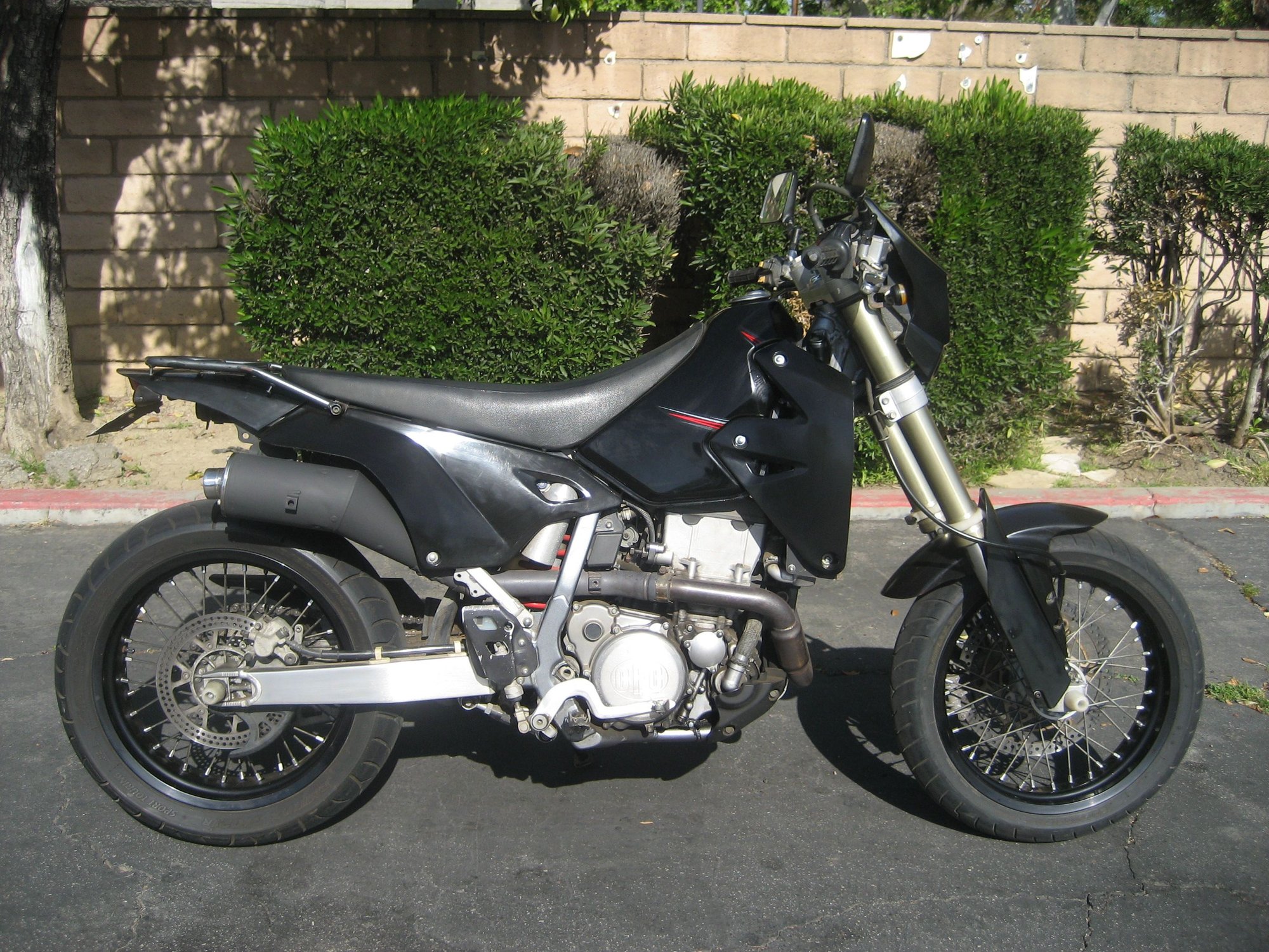

I live in a hilly area so it was easy to break my DRZ400SM in using the method you recommend. In 11 years and 35,000 miles I never touched the engine. And when I sold it, it ran just as good as the day I bought it.
I keep gas mileage records to use them as indicators of engine efficiency and they were unchanged for all the time I rode it.
