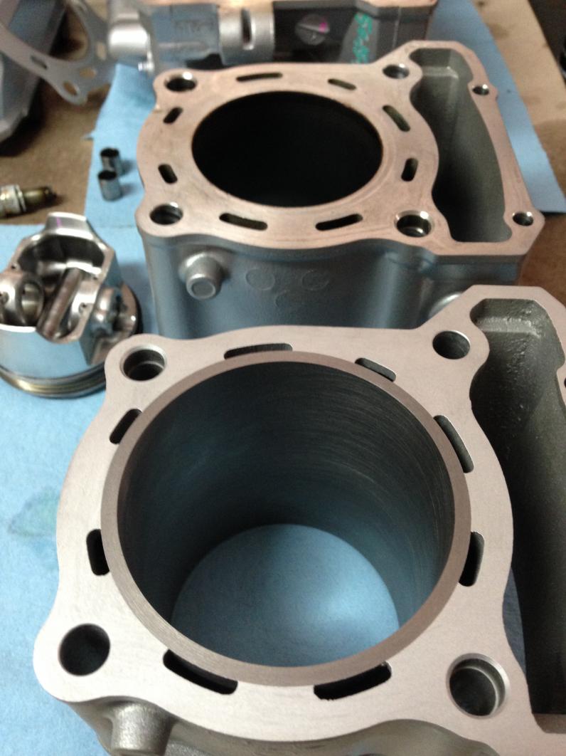

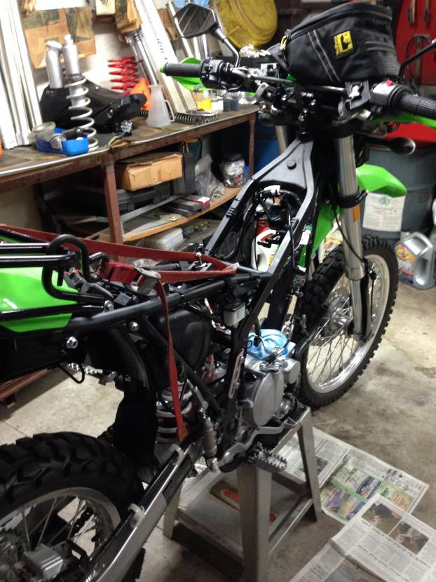

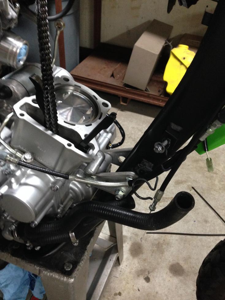

So I am a little late in posting this but I wanted to post the 351 kit install with the new carburetor, FMF Powerbomb and Q4. I also changed the rear sprocket to a 39 tooth. I couldn't be more happy with the results and wanted to post a few pics from the install and my ride in West Texas this past November. Hope you will enjoy.
