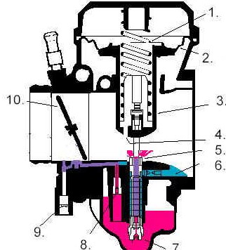

1 Slide Spring
2 Slide Diaphragm
3 Vacuum Slide
4 Vacuum Port
5 Needle Jet
6 Main-Air Jet
7 Main Jet
8 Pilot Jet
9 A/F Idle Mix. Screw
10 Throttle Plate
Attached Thumbnails How To: Take a CVK carb apart and know what the parts are-cvcarb.jpg
