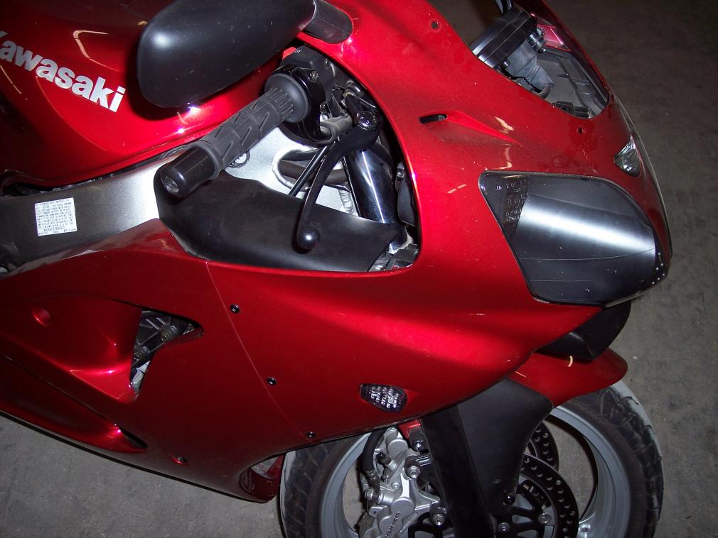

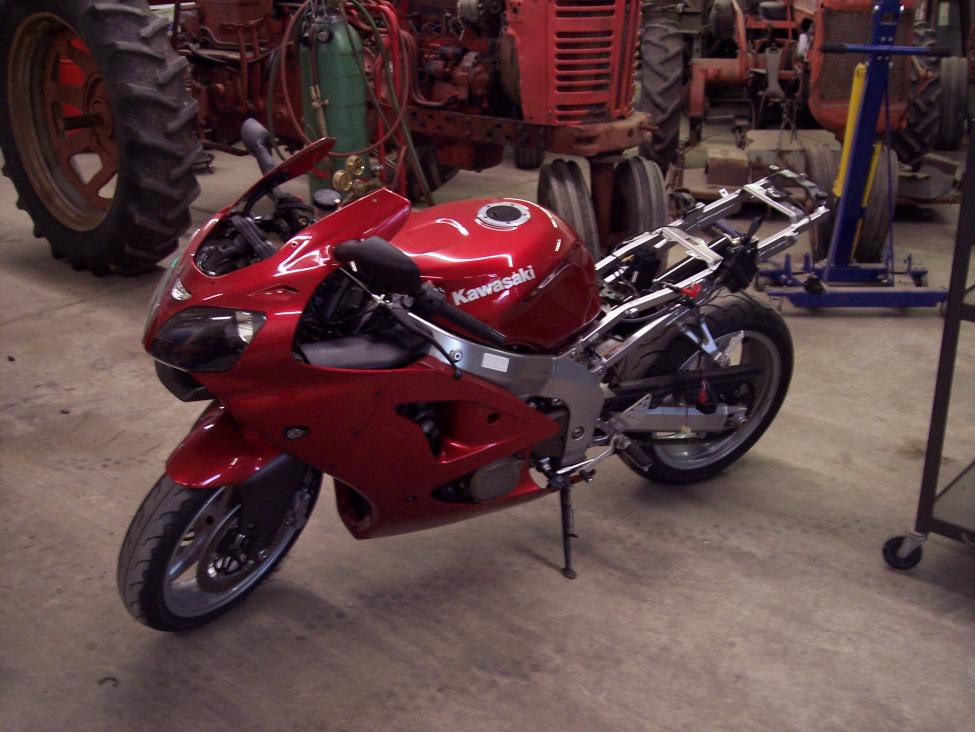

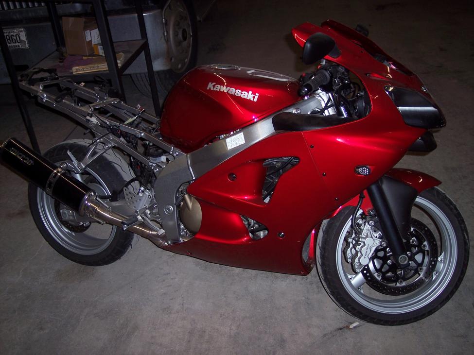

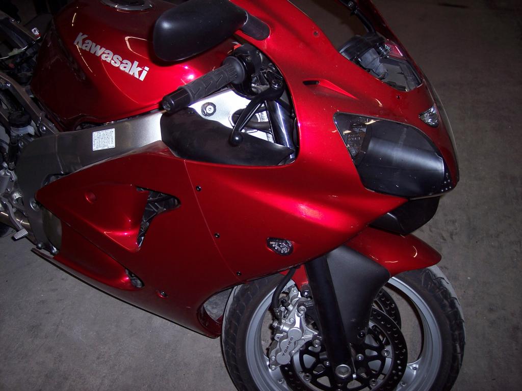

Just thought i'd put some new pics up... Still waiting for windscreen and undertail
(dang standard fed-ex shipping) , but i did get the new blinkers and levers put on. If anyone has put L.E.D turn signals and tail lights on id like to know if you fixed the fast blinking or if you let it go. any info would be a big help. Let me know what you think...
Dan

Looking good there.
to fix the FAst blinker you have to get a couple of resistors that will increase the load and force the blinker to slow down. here is a good article on how to do it :
http://cbrworld.net/forums/thread/141166.aspx
