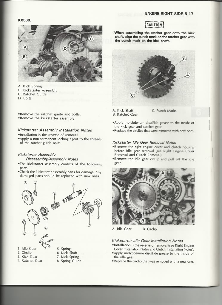

kickstarter help
I have the same problem so i took the cover off and the gears were all fine so i took the spring out and now i dont no how it goes back in can anyone help or maybe show pics on where the spring should hook on to thanks
