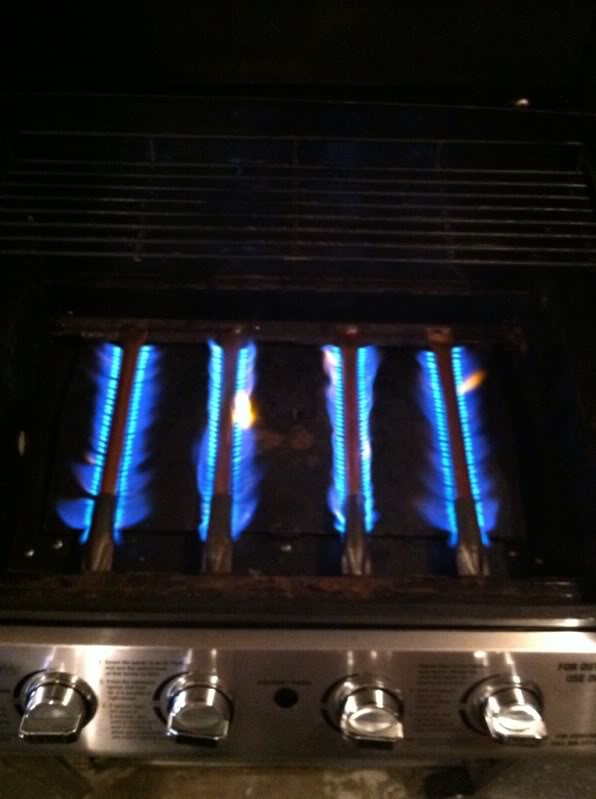

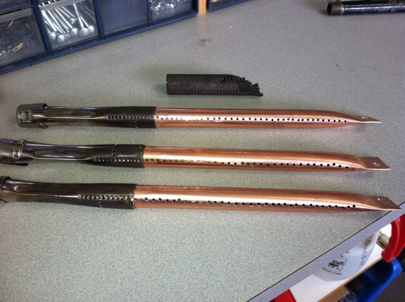

So it seems like I only get a season or maybe 2 out of my bbq burners, and I'm sick of having a new looking BBQ on the outside, while the inside is falling apart. So after doing some research and watching a video on youtube, I thought why pay $15-20 each for the burners when I can basically make them all day long for about $1.50 each. Here is the video from youtube, and then you can see below my pictures. It is awesome. because most burners only burn out toward the middle and out to the far end. So the closer part which is stainless is still really solid.

My replacements that were super easy to make.

And there you have it. Talk about awesome! one of the guys has had his in over a year and he said they still look brand new. We'll see, cause I cooks a lot of meat. Cows and pigs are running for their lives as we speak. LOL

must have had a couple of sharp edges on the outlets. Hence the orange flame.
