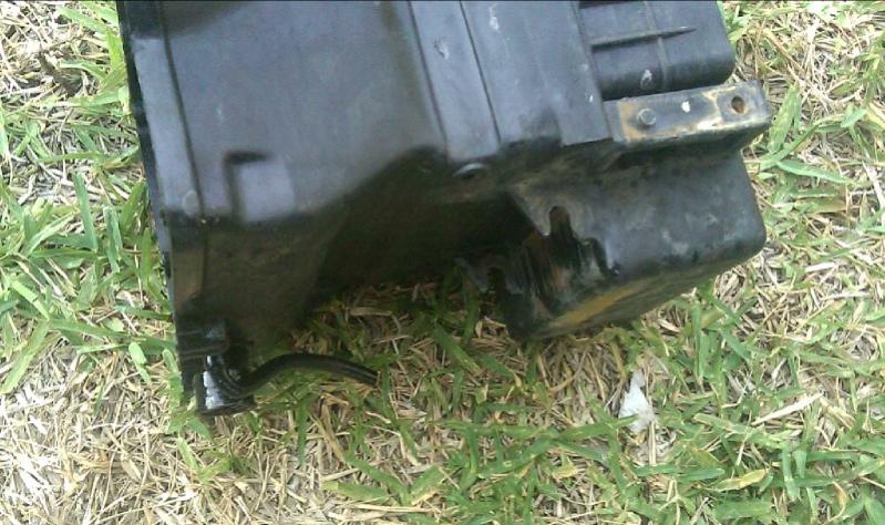

I went riding the other night with no problems and last weekend with no problems until last night when I was about to go with a friend of mine. I saw that I was leaking oil when I started the enigne. By it being night I could see where it was coming from until today. It was coming out of the breather box at the botom seams. I'm trying to post pics but I can't seem to find the attachment button. But there is a spout on top of the engine where the breather box spout goes onto. Could anyone tell me what's going on?

Here are the pics:

Its a common issue actually, a quick serch should help you out, I know itsbeen posted before, cant really remember tho.
I believe it has to do with the vacuum system not setting up the pressure in the valve cover causing a splash through the breather hose, but I cant remember. If you cant find it after a search let me know and I'll try to narrow it down.

Looks like I was close, air pressure problems causing the valve cover to vent into the airbox. Check all your hoses (I would say EGR but you dont have one do you?) and a new air filter and oil change can't hurt. Let us know how it goes, and get some pics of that classic iron up for us
Where would I check first? If I had an EGR, where would it be and how does it look? And it seems something is not breathing right either but I don't know where to start. We're getting somewhere but not there yet.

If you did, it would be on that hose you took off the breather, check your manual and the parts fiche for confirmation. Start by checking your hoses and vacuum lines for corrosion damage cracks and leaks and replace all damaged lines, old rubber tends to break. Replace your air filter, and do a oil change with a new filter and see if that fixes your problem.
