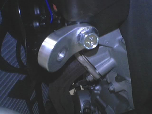

well they look similar to the ones i had on the left side it mounts here
dont mind my bracket being bent i took this pic after a slide....but that is where and how you mount the no cut to the left side....the sliders should have came with some bolts and all you do is replace the stock engine mount bolt with the one that came with the slider

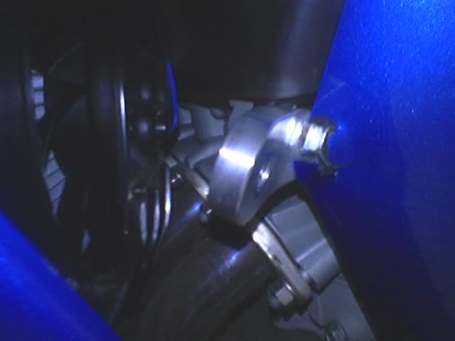

heres another shot with the fairing on
