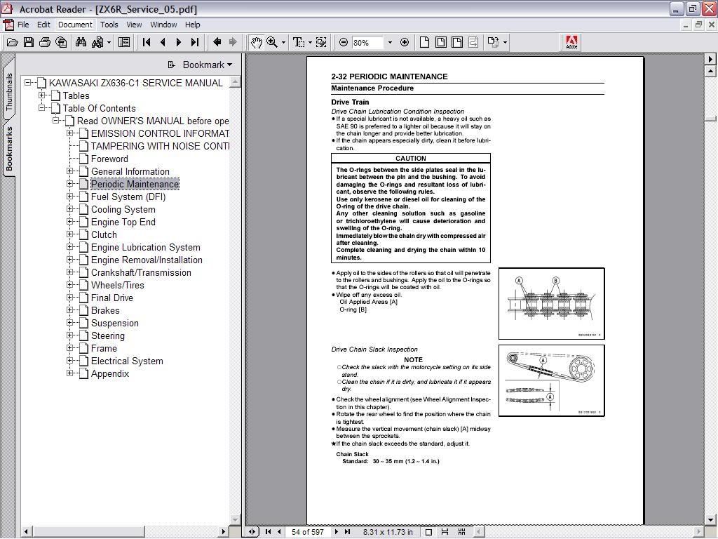

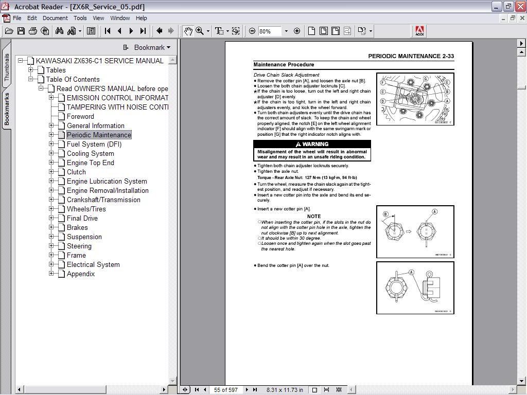

Here are a couple of pages from the manual about checking and adjusting the chain.
http://i38.photobucket.com/albums/e1...SlackCheck.jpg
http://i38.photobucket.com/albums/e1...Adjustment.jpg
I highly doubt this is causing the problem, but it should be adjusted properly.
