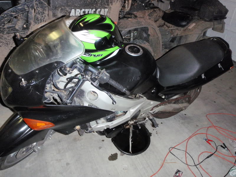

Hey thanks guys... let me post some pics of it... its not the nicest thing out there but shes my baby and im not done yet... im getting a streetfighter front end and doing a custom molding of the rear and using the zx6r seat...
