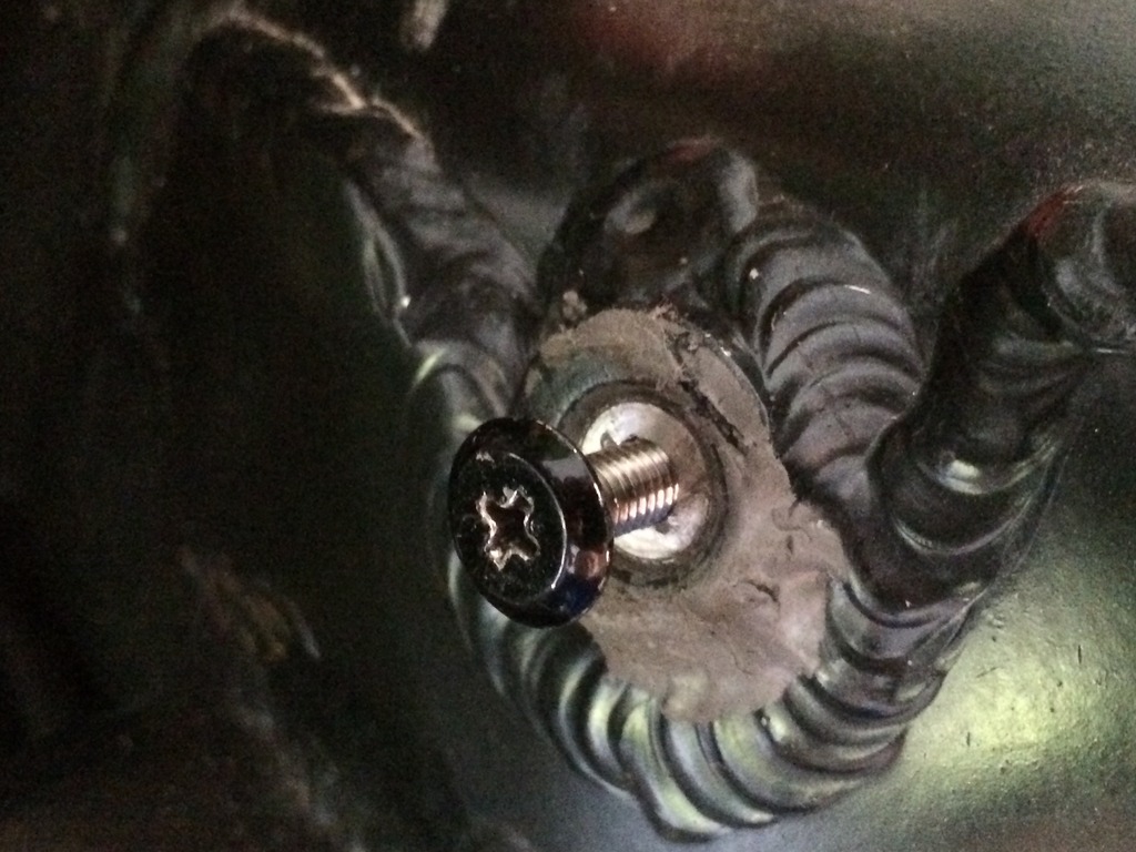

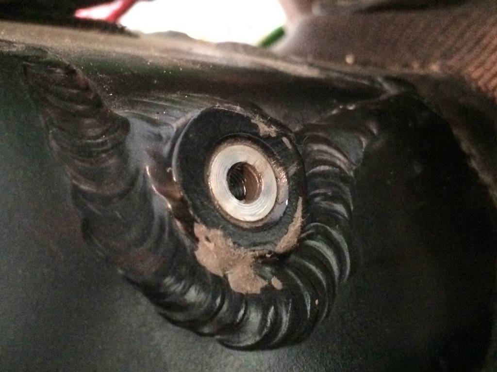

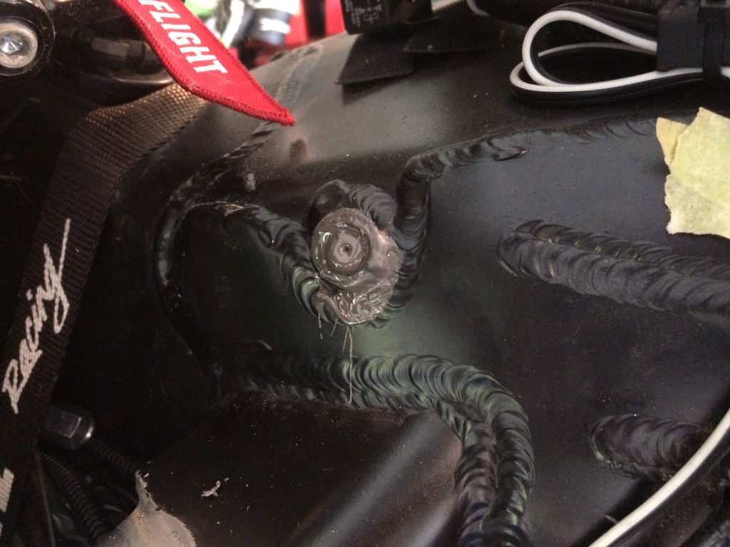

Today is my first day off work in awhile so I''ll be working on my ZX12R while I have the opportunity.
The first order of business was to get the new thread inserts installed for the tank cover.
I've had them sitting in my freezer for a week so they were plenty cold and as shrunk as I could get them without buying dry ice or liquid nitrogen.
I reamed the mounting holes to make them round and true because both were a little distorted. It wasn't much but it was enough to prevent the plugs from going in.
Then I lubed everything up with an aircraft sealant (to help the plugs go in and to seal them so I don't lose any boost).
Then I put them in. It was messy and I still needed a hammer to tap them in but they went.
Here's the left one just after installing it. I still need to clean up my mess at this point.

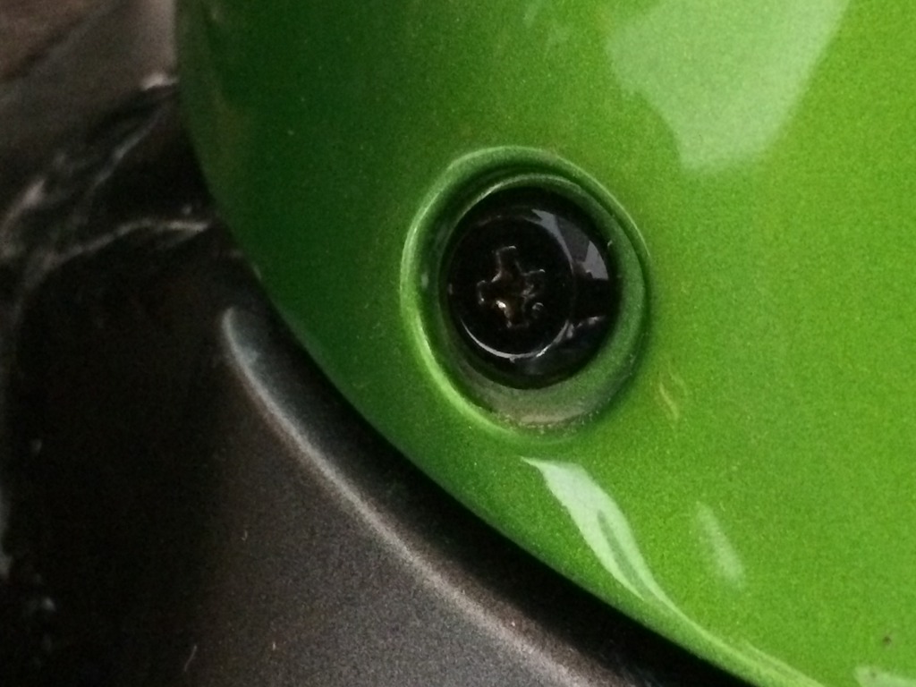

All cleaned up:
Other side:
Tank cover installed:

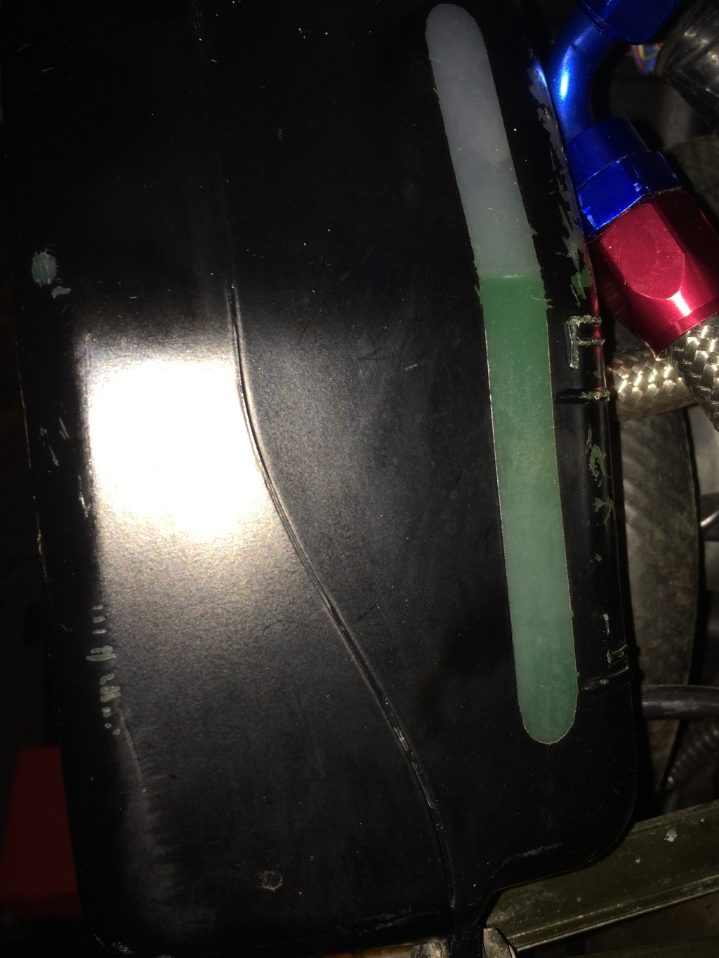

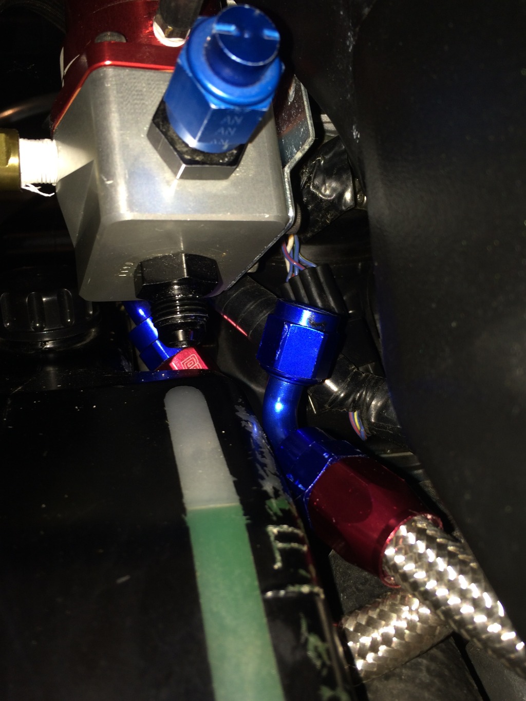

It's about time to call it a night but I'm close to having this beast roaring again.
All the fluids are topped off and there are no leaks.
The battery is charging and I have to connect the fuel return line and then I should be able to fire this thing up tomorrow.

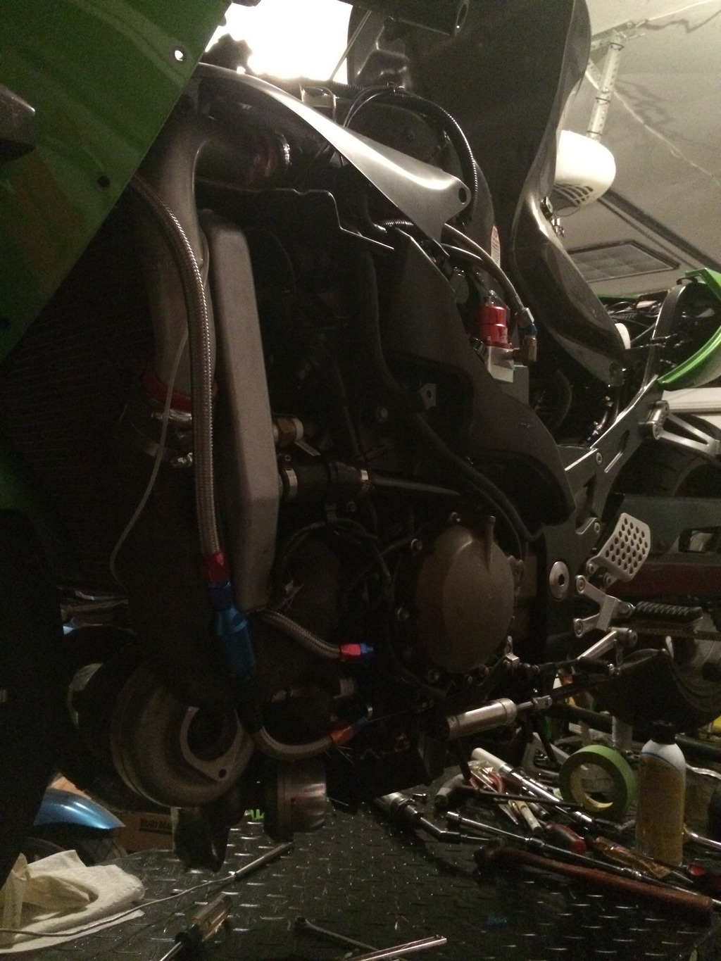

Everything is closed up, sealed and ready to fire.
