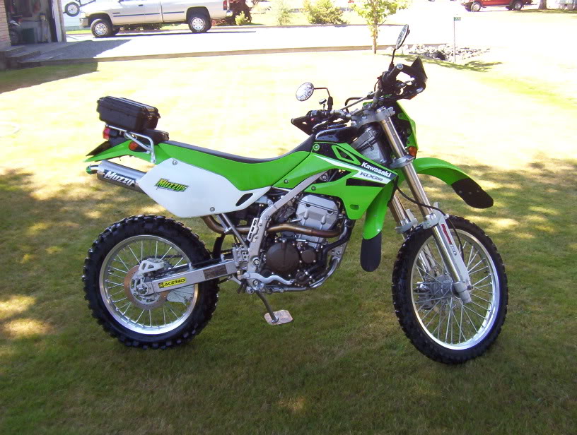

Does anyone make a link to raise this bike? I'm 6-1 and the seat height is 34, with the Dunlop 606 its not bad, but I would like to have a little more.

Not knowing your suspension, but I can adjust my ride height up to 1" I think it was for the penske race shock for the 10r to compensate for using different sized tires and still keeping my preload/sag pretty darn close. Where the stock shock, there were shims available to do the same thing. Did I make sense here? So, are there shim kits available for your ride deej?

hi deej
I don't know if somethings available but I will look in my catalogs tomorrow. I have to admit I am a little more familiar with street bikes but I will do some research in the morning and see what I come up with. cool?
