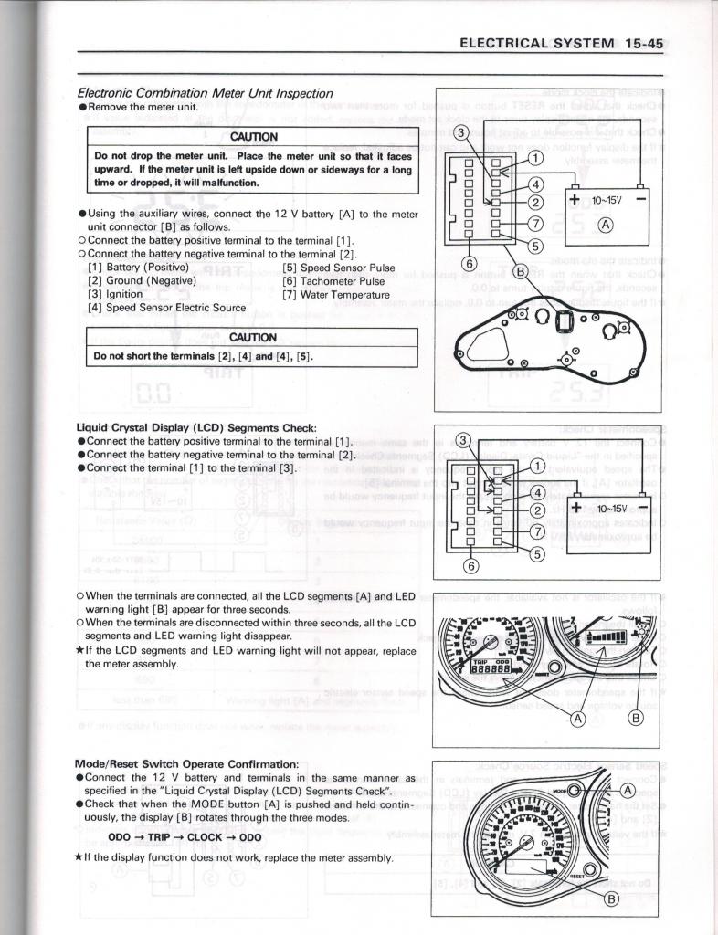

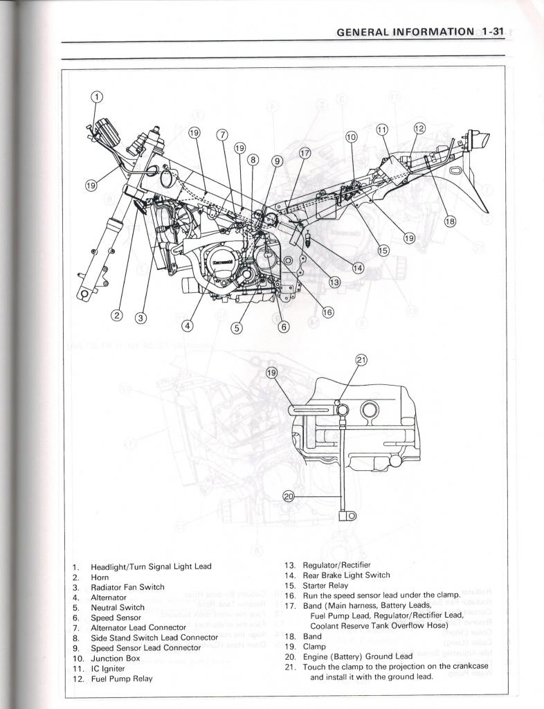

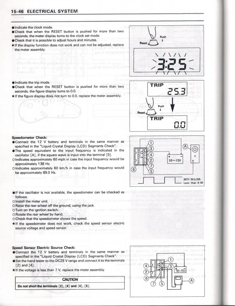

hi . can somone help me as i have just got a zx6r and the speedo is not working but i can not find the sensor to have a look at it i have looked all round the bike and now am lost on where it is ......... please help

Old Nov 28, 2012 | 07:08 AM
courtesy of KSM on where and how to test
Old Nov 28, 2012 | 07:29 AM
Old Nov 28, 2012 | 07:33 AM
I added the meter check as well so that you could check out the meters for any potential connection or operation issues. Good luck and try and get yourself the factory service manual for this ride if you plan on keeping it.

i have picked up a sprocket cover and sensor but it dose not fit the bike as there is a lug on this one and not on the bike, i have found out that it`s an F3 modle and they where a cable not what i got i am totally lost on where it is.
Dragone#19
thank you for the images but the sensor shown is not the right one the bike is an 1997 F3 model zx6r as my clocks are not the same as the one`s in the images.
