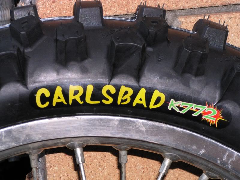

I have a K772 on the back, its heaps better than the stock 603 esp in mud the old 603 would just fill up and drop you on ya bum. The 772 grips and hooks up esp under power. I have no idea what blue groove terrain is.

Blue groove terrain, don't know. The blue groove in flattrack circles is the part of the track where the line is through the corners. The tires leave rubber on the hardpacked dirt and create a 'blue groove' line. That's where you want to stay for max speed and traction through the corner.
Good looking tire, Garry.
