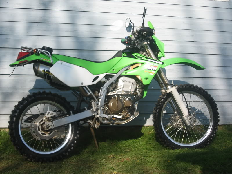

Old Jun 1, 2008 | 10:23 PM
mudjunkie's Avatar
Posts: 878
Default RE: stupid tubes!!!(or is it me?)
wooohooo!!!!...today I was able to successfully patch the front tube and install it without a leak!! The bike has been laid up for a few days and the weather has been pretty nice, so I just couldn't wait for the UHD tuibe to arrive...so instead I bought a patch kit and went to town. I also decided to give the bike a good cleaning since i hadn't done that yet this year.....oh yeah i almost forgot...used the baby powder put lots inside the tire before the tube, then also put more on the tube where u could see it after it was inside the tire. Thanks for all your help guys.
