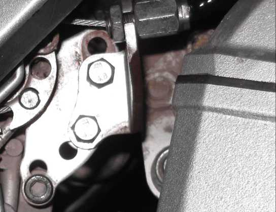

In the first pic you can see how I've ground the rivets out of the mounting bracket and used bolts instead, so that I could locate the bracket in the second set of holes. This then clears the frame, as you can see in the second pic. You can see where the bracket used to be positioned by the marking on the mid bracket.
Also note in the first pic that I modified the cable slightly. I removed one of the lock nuts and shortend the threaded part by cutting half off. This allows the cable to sit 'closer to the stay', giving it a kinder bend up and over the cam cover. I've had it routed like this for 6-700 enduro kilometers without issue.
