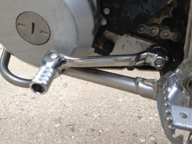

Bent my stock shift lever near the base weld. It broke when I tried to bend it back. Searched for replacement options. Went with the MSR 34-2176, SF-6413. It is aluminum, which will likely break before bending far, but it's light, fits/functions just like stock lever and it looks good. At $26 shipped, it's about half the cost of the stock steel lever. I got two, so I can carry a spare. It even comes with the pinch bolt, for which the steelership probably charges about $4.

Weld your old one back together and you will have three

... It is aluminum, which will likely break before bending far ...
As long as it breaks before the shift shaft ....
That's the plus of the "cheesy" bendable steel one, it's a safety

I'm mildly concerned about the shift shaft. Is breaking it really that common? I have an '09, so I'm somewhat concerned about the shift star. It survived the spill that bent the stock lever. If it goes, it gets upgraded. Anyone use a brake lever saver on the shift lever? I've seen that option listed in product descriptions. I do plan to weld the OEM lever back together, but the replacement was fast and easy. I ordered it late Tuesday night and it arrived to me in Milwaukee from CA today.

I run a Banshee shifter with a welded on folding tip. Banshee shifter is longer and seems to work better with moto boots.
Old Aug 12, 2013 | 09:17 PM
The shift lever for the Honda XR650L also fits and is a bit longer. I have one on the bike now.

I also use a brake snake on the stock shifter. Made a template off a new stock shifter bend I posted here somewhere if you want to straighten one out.
