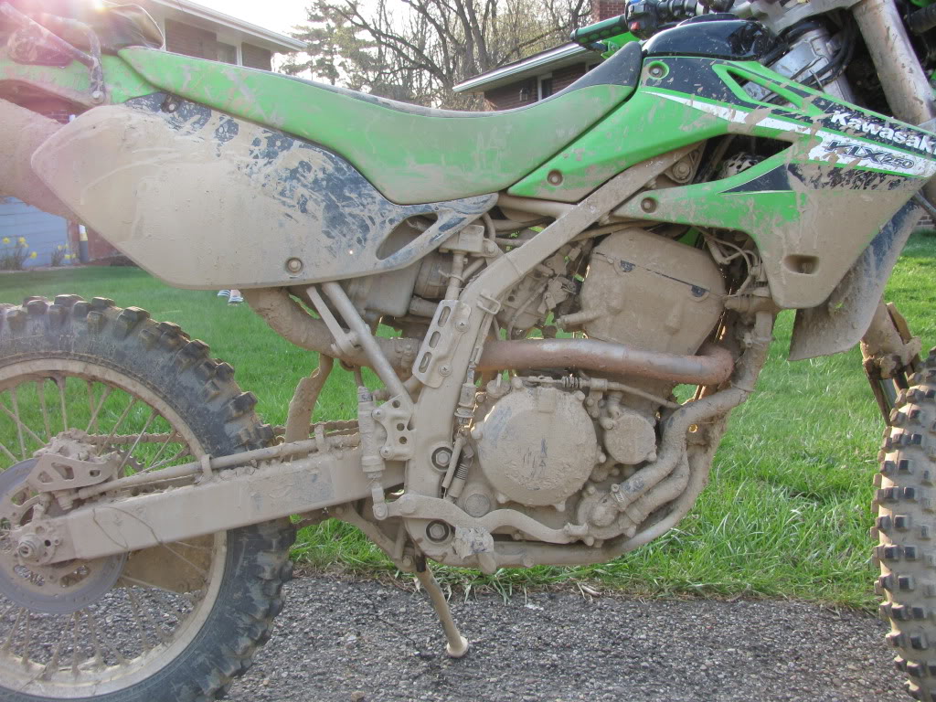

yea yea.... your bike stays clean when your only riding in sand..... come up here...
